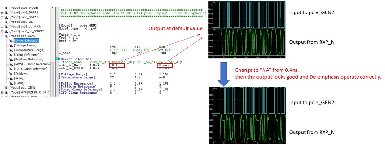

The customer simulate TUSB7320 by using TUSB7340, TUSB7320 IBIS Model, then they found incorrect output as attached. They tried to change the value of usb3_de_MAIN from 0.4ns to NA then they could see correct output. Can you check it and confirm if this change it correct for proper operation?
