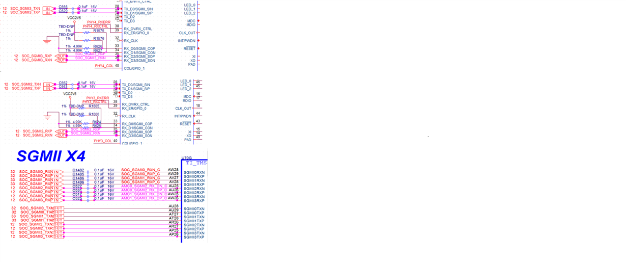

We are trying to bring up the four 1Gig Ethernet ports in customized k2hk board.
-> First two Ethernet ports ( eth0 and eth1) with  Marvell chip using sgmii interface.
     status:  working,  as in the k2hk evm board
-> other two Ethernet ports (eth2 and eth3 ) with TI DP83867 using sgmii interface.
      status: Shows up the interface, but unable to ping.
step followed to bring up TI DP83867
In kernel
-> because of unavailability of driver for dp83867 in mcsdk kernel , we moved from mcsdk to Processor SDK  .
-> we did the changes in device tree , PFA of device tree.
-> we did the changes in dp83867 driver, because it support only RGMII mode, but we need  SGMII mode of operation, PFA of modified driver and original driver .
-> SGMII mode related modification are borrowed from the boot loader file ti.c , PFA of ti.c
We also tried in  PSDK Boot loader
-> Enabled the ti.c which in in the path /driver/net/phy/ti.c , tried to ping other ip , but system restarts.
Please help us in getting this up.

    To help you with debug, first I would like to confirm that your Hardware design/routing is correct. Can you please go thru DP83867 troubeshooting uide section 2.10 "Establishing SGMII link" and confirm everything is ok ?
    Post this I would like to check, whether the AutoNegotiation process between SGMII and MAC is complete ?

    we gone through the DP83867 troubleshooting guide section 2.10 "Establishing SGMII link", below are check points
    1 The DP83867 includes internal SGMII terminations. No external terminations are required.
    >No external termination provided.
    2 All SGMII connections should be AC coupled via an 0.1-μF capacitor.
    > All SGMII connections are AC coupled via an 0.1-μF capacitor.
    3 Traces should be routed with 100-Ω differential impedance.
    >Yes
    4 Skew matching within a pair should be less than 5 pS, which correlates to 30mil for standard FR4.
    part of net name Length
    PHY1
    SOC_SGMII2_TXP 4232.48 MIL
    SOC_SGMII2_TXN 4224.35 MIL
    SOC_SGMII2_RXP 3231.04 MIL
    SOC_SGMII2_RXN 3254.53 MIL
    PHY2
    SOC_SGMII3_TXP 5702.97 MIL
    SOC_SGMII3_TXN 5713.57 MIL
    SOC_SGMII3_RXP 4584.06 MIL
    SOC_SGMII3_RXN 4617.22 MIL
    5 When operating in 6-wire mode, the RX pair must match the Clock pair to within 5 pS, which correlates
    >Operating in 4 wire mode.
    6 When operating in SGMII mode, dummy straps may be necessary to provide a balanced load for the
    SGMII differential pairs. Therefore, for SGMII applications with straps configured for RX_D0 and/or
    RX_D2, matching terminations must be used for RX_D1 and/or RX_D3. For more details, see the PHY
    Address Configuration section of the data sheet.
    >Provided
    7 When establishing an SGMII connection between the MAC and the PHY, both the MAC and the PHY
    should have a common configuration. SGMII Auto-Negotiation is the preferred mechanism for
    establishing communication. If Auto-Negotiation is not used, both the MAC and the PHY must be
    forced to the same speed and duplex configuration.
    > below register setting done in the dp83867.c and also attached file with query

    8 Unstable MDI link can result in unstable SGMII connection. If the PHY cannot maintain a link, it can
    cause the SGMII Auto-Negotiation to loop. The unstable MDI link must be resolved in order to resolve
    the SGMII Auto-Negotiation loop.
    > how to test................................ ?
    Gireesh Hiremath
    Lekha Wireless
  • 8 : It says, the MDI side link shall be stable to complete the SGMII Auto Neg. This can be check thru Link Status register. Further you can look at SGMII Status Register to undrestand the status of this link. "SGMII Auto-Negotiation Status :0x0037"
    Then I would like to try the MAC loopback mode and check whether you are able recieve the packets back or not.
