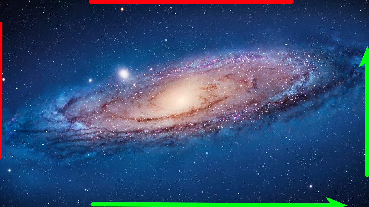

I had used sn65dsi83 on my project, the soc is qualcomm MSM8909, and the display almost ok, but I still have a question here:
my original picture is :
but the display show:
The button of the display works abnormal, did you have any suggestion for  me?
Thanks.
B.R.
  • Hello xingxing Luo,
    Could you please share the panel datasheet along with the .dsi file or DSI Tool screenshots? I would need to know your configuration.
    Please, also generate a complete register dump including the status register at offset 0xE5 and 0xE6.

    0xE5 is 0, and I din't found 0xE6 register.
  • Hello xingxing Luo.
    Regarding your clock configuration, it seems that your DSI clk frequency is not enough to support a pixel clock of 70MHz 24bpp.
    Stream Bit Rate = PixelClock × bpp
    Stream Bit Rate = 70 × 24 = 1.680 Gbps
    Min Required DSI Clock Frequency = 1680/ (4 × 2)
    Min Required DSI Clock Frequency = 210 MHz
    Could you please use a DSI Clk frequency of 210MHz instead of 161MHz and a divisor of 3 instead of 2?
    Also, confirm the new line time requirement in the tool (output tab) and the actual line time in the GPU?
  • Hi Joel:
    My current DSI clk frequency is 161MHz, and divisor is 2, so the SN65dsi83 clk is 161/2 = 80.5, it was bigger than 70MHz, did I misunderstand your means?
    Anyway ,I will try your suggestion.

  • Hi xingxing Luo,
    Please, try the attached configuration. I have set the pixel clock to 59.7MHz as per the panel's datasheet and an input DSI clock of 180MHz.
