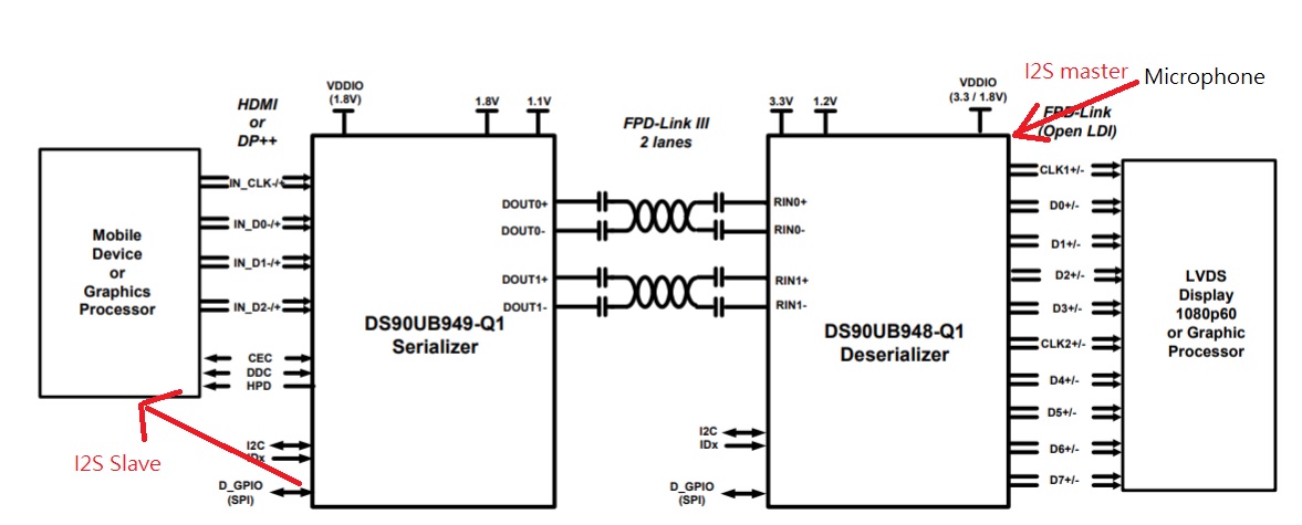

I saw DS90UB949 can support I2S master and slave mode
May I use I2S microphone for below structure ?

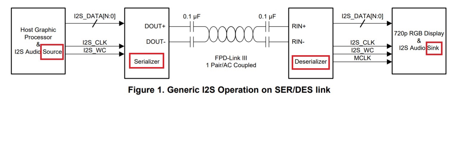

Kai,
No, it can support the reverse I2S transmission from de-ser to ser.
