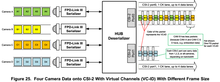

My customer would use DS90UB964-Q1 (or maybe DS90UB962-Q1 later) with four cameras which has DS90UB913A-Q1.
One of camera has slightly different frame size which cauase different PCLK rate than other three cameras.
One camera (DS90UB913A-Q1): around 98MHz
Other three cameras (DS90UB913A-Q1): around 94MHz
From the drawing 25 in the datasheet, it seems that these different frame size (PCLK) can be supported by DS90UB964-Q1.
Are there any of limitations involved? It's also helpful, if you can share the idea how I can proof this configuration.
