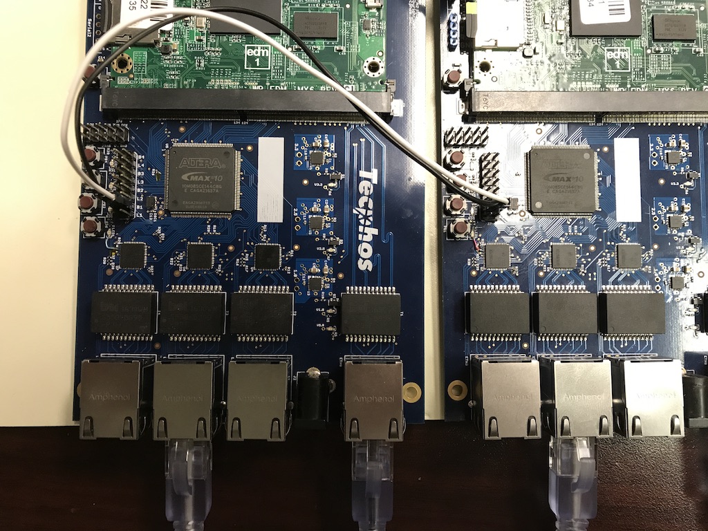

  • Here is a photo of our two early prototype boards to help you envision our setup.  The 4th RJ45 on each board goes to an Atheros 8031 PHY connected to an ARM processor.
  • We have another test result today based on your question about how the reference clocks are generated.
    1. In our previous tests each board used its own 25MHz oscillator.  The PHYs would not connect between boards even if the boards grounds were tied together.
    2. We reprogrammed the FPGAs so board A would transmit its 25MHz clock to a test point.  We reprogrammed board B to accept a reference clock on a test point and ignore its oscillator.
    3. When PHYs on both boards are using a reference clock from the same oscillator the PHYs connect without error.
    You can see in the picture, the clock signal integrity is far from ideal, but it works better than the independent oscillator (which you can see right next to the test points).
    This leads me to the conclusion the issue is not magnetic, termination, or power related.  It seems to be some sort of reference clock problem.
    We are going to try some different clocking options in the FPGA to see if we can learn more.
    I still welcome any insight or recommendations.
