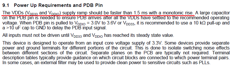

Hi Team,
The datasheet shows the VDD33 and VDDIO supply ramp should be faster than 1.5ms with a monotonic rise.
(datasheet page 41)
What is concern if VDD33 and VDDIO supply ramp is slower than 1.5ms?
(What is occured if VDD33 and VDDIO supply ramp is slower than 1.5ms?)
