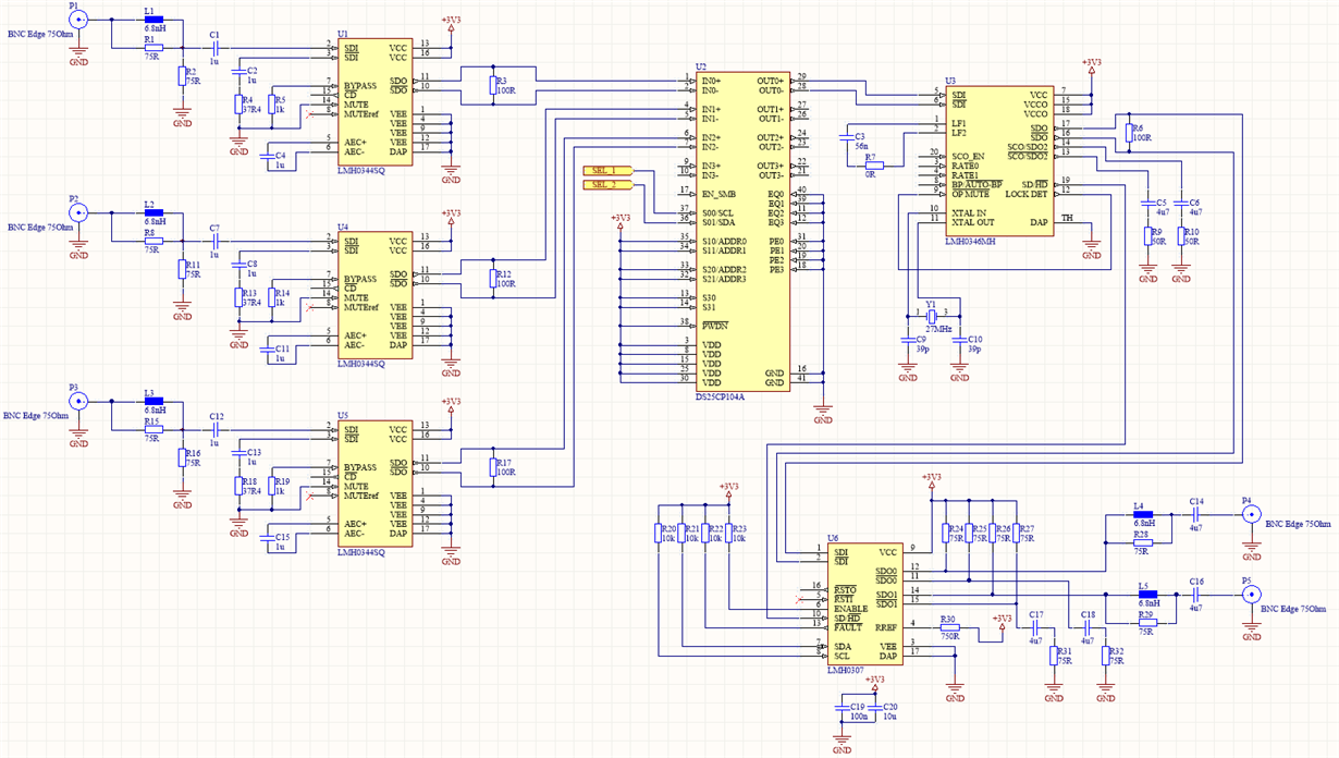

I am currently working on a 3G-SDI 3:1 Switch design with splitted Output. I Have created a first draft of the schematics and would like to know if this would work in principle or if there are mistakes. Especially, I am not so sure if I used the 100 Ohms Termination resistors correctly. Furthermore, what should I do with the unused Input and Output Pins of the DS25CP104A?
See my circuit below:
Thanks!
