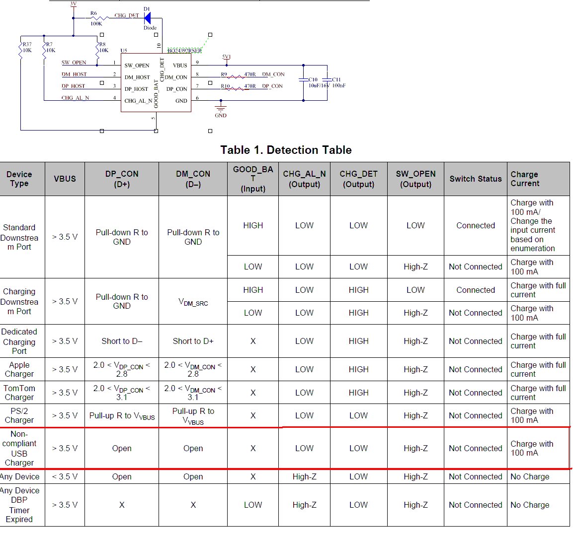

BQ24392: CHG_DET output is high even if DPDM are open and vbus is >3.5V
Part Number: BQ24392

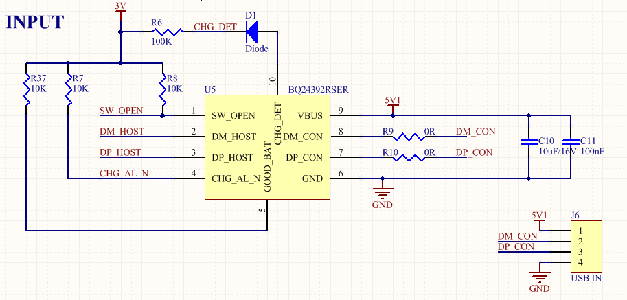

I am using BQ24392RSER for the charger detection application. This IC is working fine except for following scenario,
VBUS is 5V,
DP and DM (pin #7 and 8) are open.
Pin 2 and 3 are connected with the MCU DP and DM.
I have used boost circuit which is generating 5V output and connected with VBUS of this IC. Now problem is that, when Boost circuit is ON, then this IC is giving indication of charger insertion. Hover there is nothing at input, i.e at pin #7 and #8.
So I am not getting condition where VBUS>3.5V, DP-DM are Open and CHG_DET output = low as mentioned in detection table-1.
Can anyone please help me on this. Please find attached image for circuit and table.
