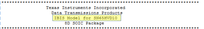

Hi Team,
Could you please help to confirm if the below IBIS model file is for the SN75HVD10?  I found that in the ESP link, but the part number in the model seems not correct.
http://www.ti.com/lit/mo/sllc114b/sllc114b.ibs
  • Hi Lilian,
    This model looks correct. The same IBIS model is used for both SN65HVD10 and SN75HVD10 since the devices have the same electrical performance and only differ in temperature rating.
    Please let me know if you have any more questions.
