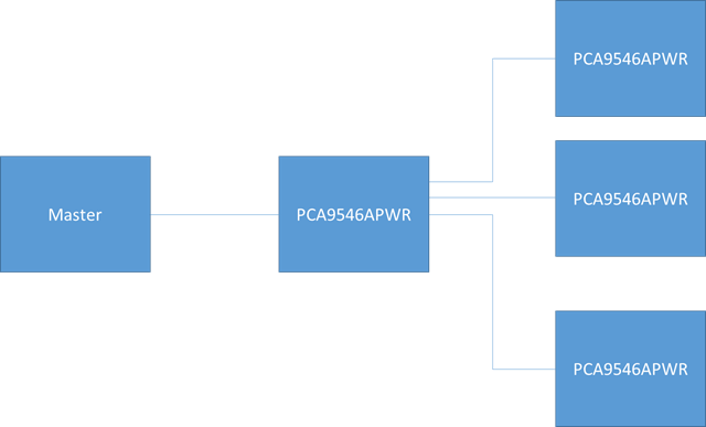

Part Number: PCA9546A
Hi Team,
Please help to check if the PCA9546APWR can be cascade as below.

Hello SHH,
It is possible to do this but you have to take some care in selecting the correct pull up resistor that affects both the Effective Vol at the slave and the required rise time. That also means you take care in the amount of capacitances are on the bus due to parasitics and the amount of slaves on each bus. Ideally use polling for each channel and not turning on all channels at once.
