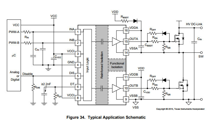

Hello TI,
i am confused with the usage of bootstrap diode.
From the datasheet, it shows that the typical application only has the bootstrap diode connected to the VDDA side.
  • Why is there are no bootstrap diode on the VDDB side?
  • Are the values Cboot and Cvdd different? And why so? if it perform the same switching task.
In the datasheet, page 4 (Pin Configuration and Functions) only states that the decoupling capacitors are needed on VDDA and VDDB.
