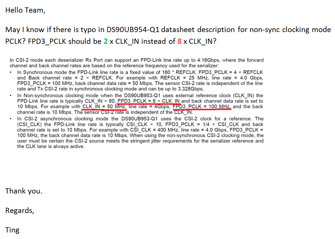

DS90UB954-Q1: FPD3_PCLK = 2 x CLK_IN in non-sync clocking mode?
Part Number: DS90UB954-Q1
