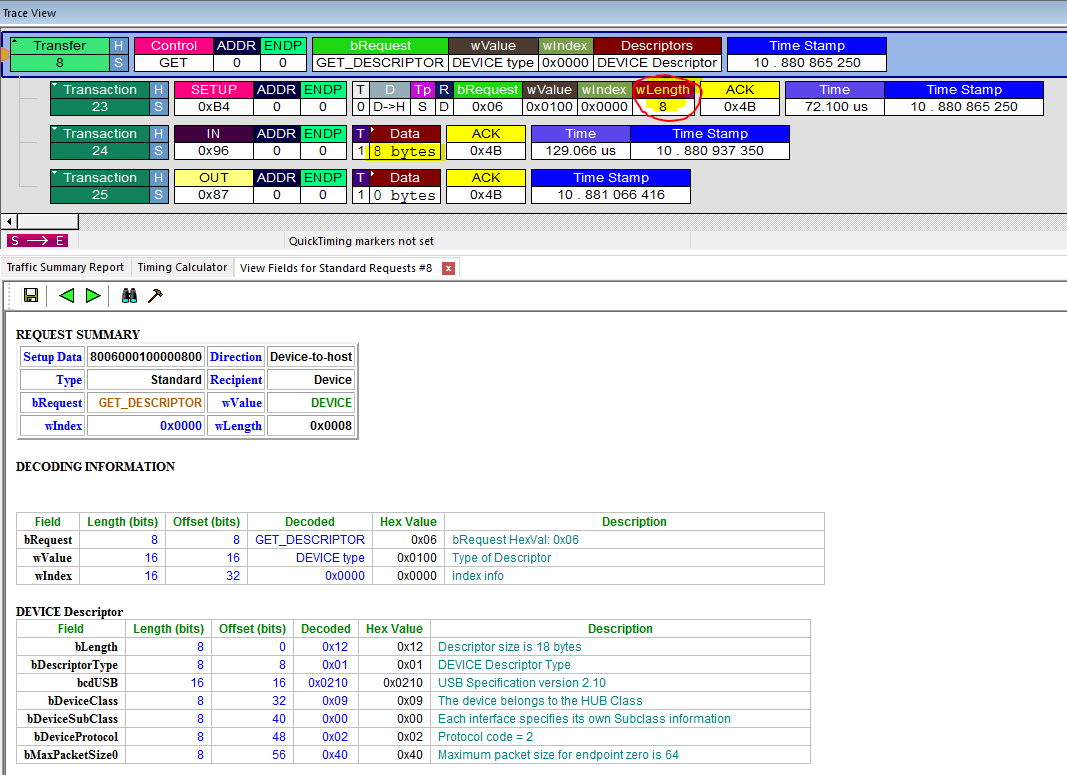

1.When system request 64byte length device descriptor, TUSB4041I returns 0x00 as bDeviceProtocol.
2.When system request 8byte length device descriptor, TUSB4041I returns 0x02 as bDeviceProtocol.
Our System requests 8byte length devide descriptor in Address-assigning phase, then System returns [Illegal Device Protocol] & enumeration failed.
(Tther system (windows 7,etc),System request 64byte length device descriptor in Address-assigning phase, Enumeration finished successfully.
    If bDeviceProtocol is 0x00, that would indicate the TUSB4041I was somehow enumerated as FS/LS device.
    For 2.0 hubs operating in HS, bDeviceProtocol indicates whether hub has multiple TTs (0x02) or only a single TT (0x01). TUSB4041A has multiple TTs.
    Check the USB 2.0 specification at section 11.23.1
    Regarding to the error you are seeing when requesting 8 bytes from the device descriptor, I would recommend you to check your system's host controller driver for other possible issues, as the TUSB4041I would properly return the requested 8-bytes. The screenshot bellow shows a protocol analyzer capture when using the USB 3 Gen X CV tool to get 8 bytes from the device descriptor; as you can see data is being properly returned.
    Do you have a protocol analyzer capture you can share showing the issue you are experiencing?
