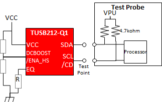

TUSB212-Q1: Assembly Test with I2C mode
Part Number: TUSB212-Q1
[ TUSB212-Q1 ] Assembly Test with I2C Mode

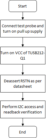

I have suggested customer to perfome the assembly test with I2C mode in conjuction with test probe as below.
This test is for making sure whether TUSB212-Q1 device is assembled and configured correctly.
Can you double check the drawing and flow-chart?
Ken
