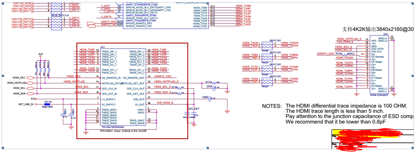

Hi Bros,
My customer is using our HDMI ESD. Recently, they found 20 in 500 products' HDMI port broken in field application. During testing, the differential lines shorted to ground, but strange is that our ESD IC still good. Seems ESD protection IC doesn't protect our HDMI? Below is the sch. Do you have any suggestions for the reason or sch comments?
