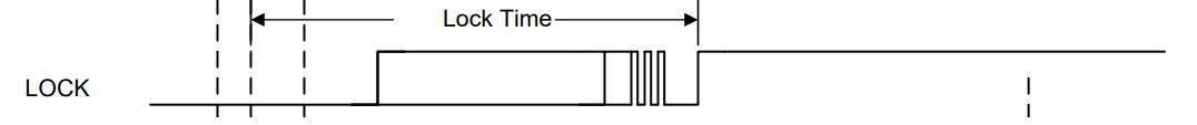

I will use the LOCK pin for interrupt to MCU.
Could you tell me the minimum time of tDDLT?
If the minimum time is very shot, MCU can not receive the interrupt.

The minimum tDDLT should be irrelevant. When LOCK is going from low to high, it is not a single edge transition.
A simple interrupt on LOCK may not work as expected.
One approach would be setting a timer from clock received to 30ms, then interrupt on LOCK signal.
LOCK transition from high to low is single edged, so interrupt on loss of LOCK has no problem.

I will use the lock transition from high to low for interrupt to MCU.
I want to re-transmit if the unlock occur.
Could you tell me the minimum low pulse width of LOCK signal?
