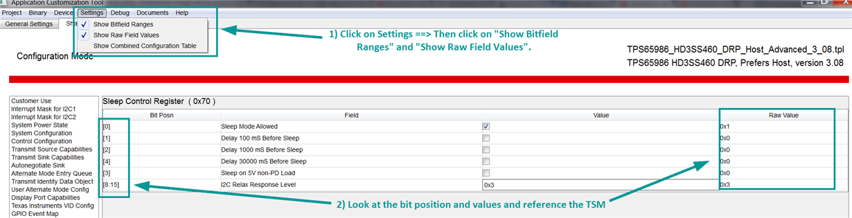

Can we combine the values of the sleep time register? I notice they are check boxes vs a drop down menu.
I also see an option for 30s delay, but that is not on the TRM. Is it safe to assume that 30 second delay is the 111b (reserved)?
If we dont check any of the boxes, I assume it will default to 001b. What does this translate to in terms of delay seconds?

    1) Can we combine the values of the sleep time register? I notice they are check boxes vs a drop-down menu.
    Unfortunately, no we cannot combine the sleep time delays. I would recommend choosing one of the checkboxes. If multiple boxes are selected, the GUI will configure firmware to the highest sleep delay value checked.

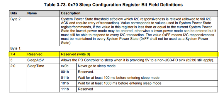

    2) I also see an option for 30s delay, but that is not on the TRM. Is it safe to assume that 30 second delay is the 111b (reserved)?
    Good catch. The TRM will probably need to be updated to show this. The 111b isn't reserved for this. bit value 4 is (look below):
    3) If we dont check any of the boxes, I assume it will default to 001b. What does this translate to in terms of delay seconds?
    If you don't check any of the boxes, it will go to 000b. This means sleep mode is disabled. If the customer were to check ONLY the "Sleep Mode Allowed" box (001b), then sleep mode is enabled but without any time delay.

    Also, I would recommend setting the GUI tool to show the bit values. This will help when referencing the TRM for bit values (look below). I hope this helps :-)

    -Is the 30s delay timer recommended? Bit 4 is under reserved and not explicitly labelled on the TRM so I wasn't sure.

    5) Is the 30s delay timer recommended? Bit 4 is under reserved and not explicitly labeled on the TRM so I wasn't sure.
    We recommend the 1000ms. The 30sec delay timer is primarily used for debugging purposes, and I believe that's why it isn't listed in the TRM.
