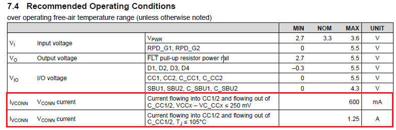

TPD8S300: two IVCONN recommendations
Guru 29720 points
Part Number: TPD8S300
Hi Team,
There are two IVCONN recommendations in datasheet.
Could you tell me why do two recommendations show in datasheet?
I translate the meaning as the following.
- VCONN current should be less than 600mA if we want to set CCx voltage drop less than 250mV.
- VCONN current should be less than 1.25A if we want to set Tj<105℃.
Is my understanding correct?
