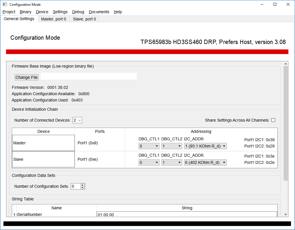

I made a PCB and I did not work so I started debugging. I noticed a lot of things that are not correct/missing in the datasheet and the configtool 3.08 has bugs.

Config tool:
1. DBG_CTL1 and DBG_CTL2 are swapt with the hardware. So in the config tool DBG_CTL1  = DBG_CTL2 and DBG_CTL2 = DBG_CTL1
2. config tool manual is for 3.07 instead of 3.08
3. What is wit the "Ports" column. The column says Port1 but the tabs say port0. What kind of address is it?
