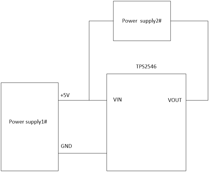

Do we have any specific tool to measure the TPS2546 charging current? For example, how can we make sure that TPS2546 can output 2A current? Can we do that on the EVM?

It can be done with the EVM. Set the TPS2546 to be in DCP auto (or really any DCP mode) and connect a power resistor decade box (or some adjustable load). I connected the load to the VBUS test point and the GND test point closest to the VBUS test point. Make sure to power the EVM from it's own power supply as well. I was able to do around 2.5A before the fault LED turned on.

Thanks a lot for providing this. If TPS2546 has been built in customer's system, can we measure that using the same method?
