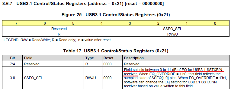

Hi Team,
I would like to ask about SSEQ_SEL[3:0] in 0x21 register.
I believe EQ=11dB is set when SSEQ_SEL[3:0]=1011.
Is my understanding correct?
If the answer is yes, what dB is set when SSEQ_SEL[3:0]=1100~1111?
Best Regards
Yaita / Japan disty
