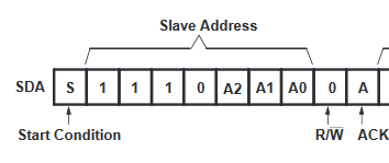

    -The TCA9544A has a programmable address. The address will depend on what you connected pins a0, a1, and a2 to.
    The address of the device assuming a0, a1, and a2 are tied to GND will be:111 0000 or 0x70h
    If a0, a1, and a2 are tied to Vcc with a pull up resistor: 111 0111 or 0x77h
    The last bit is R/W which if 1 will be a read, and 0 will be a write. You will want to use 0 to first write to the register.
    Once a start condition has been initiated, you send the slave address with the R/W bit. If the slave address is correct, you should see the TCA9544A pull down on SDA line signifying an ACK bit after the R/W bit is sent. This will tell you the device has gotten the message you've sent.

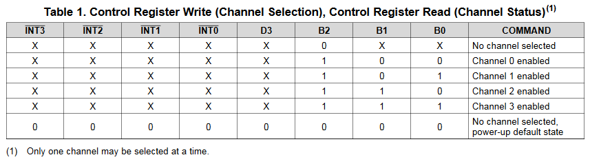

    After you have received an ACK from the device, you will need to send a byte of data to the control register of the TCA9544A to turn on the channels you need.
    In the table above, you do not care about the INT bits as you are writing and not reading. D3 is also a don't care term. B0, B1, and B2 are the only bits you care about. This device allows you to turn on only one channel at a time, which in your case is what we want. Also, at start up all channels are off. Lets say you want to turn on Channel 0.....
    You can send the following byte, 0000 0100 or 0x04h to select ch0

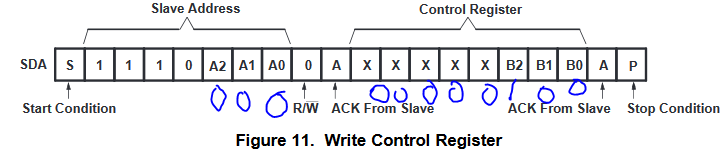

    Alternatively, you could send 1111 1100 or 0xFCh and still turn on ch0. As long as you don't mess with the two LSB and have bit 3 a 1, Ch0 will be selected.
    You should get an ACK after the last bit and then you can initiate a stop condition.
    The above example shows a full write command to the TCA9544A. The addressing bits are all pulled to GND shown by the zero bits on a2, a1, a0. The control register is written to as 0x04h. Afterwards the stop condition is initiated, which turns on ch0.
