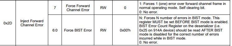

Hi tried to disturb the link cable with a capacitor in parallel between R+ and GND on DESER, I also tried disconnecting the cable but the value of BIST ERROR COUNT register (ADDRESS=0x25 DESER) remain to zero.
He  tried to configure the BIST test even via hardware mode (DESER pin BIST_EN=1, GPIO0=0 and GPIO1=1) but the result is the same.
How can he make the BIST procedure correctly? Why the BIST ERROR COUNT register (ADDRESS=0x25 DESER) remain to zero?? How can Ihesimulate an error during BIST test to verify the counter increment??
    Disconnecting cable during device operation is not a normal condition. It is not recommended doing that to force error.
    The BIST setup you listed is correct. It should correctly enable BIST mode.
    If you would like to force error in BIST mode, register 0x2D on 913A device could be used.
    If you set 0x2D[6:0] before enabling BIST mode, the same amount of error should be recorded in BIST ERROR COUNT register (ADDRESS=0x25 DESER) after BIST mode disabled.
