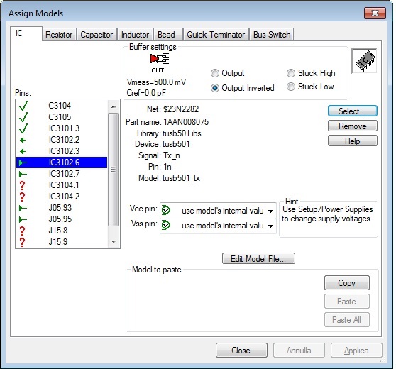

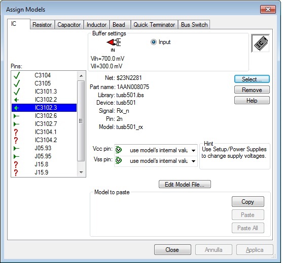

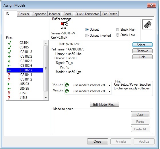

The picture show the model assigned to the TUSB501 redriver (IC3102)

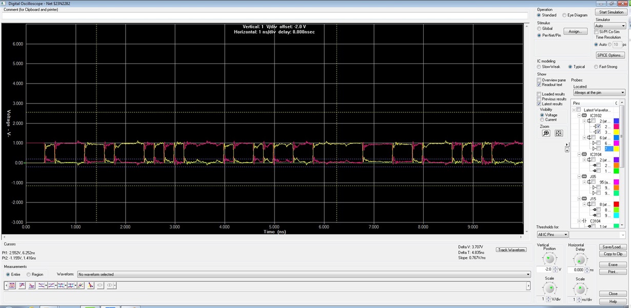

This is the stimulus for the smd connector (SSTX output pair modeled as TUSB501 tx output pair):
This is the IC3102 input signal at pin 2 and 3:

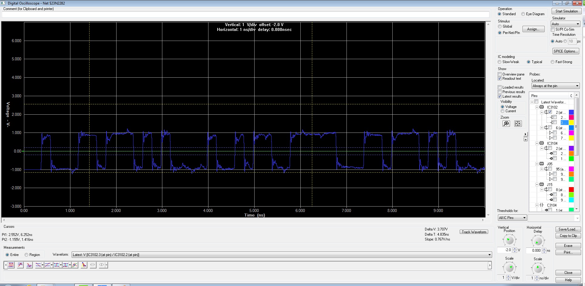

This is the differential signal

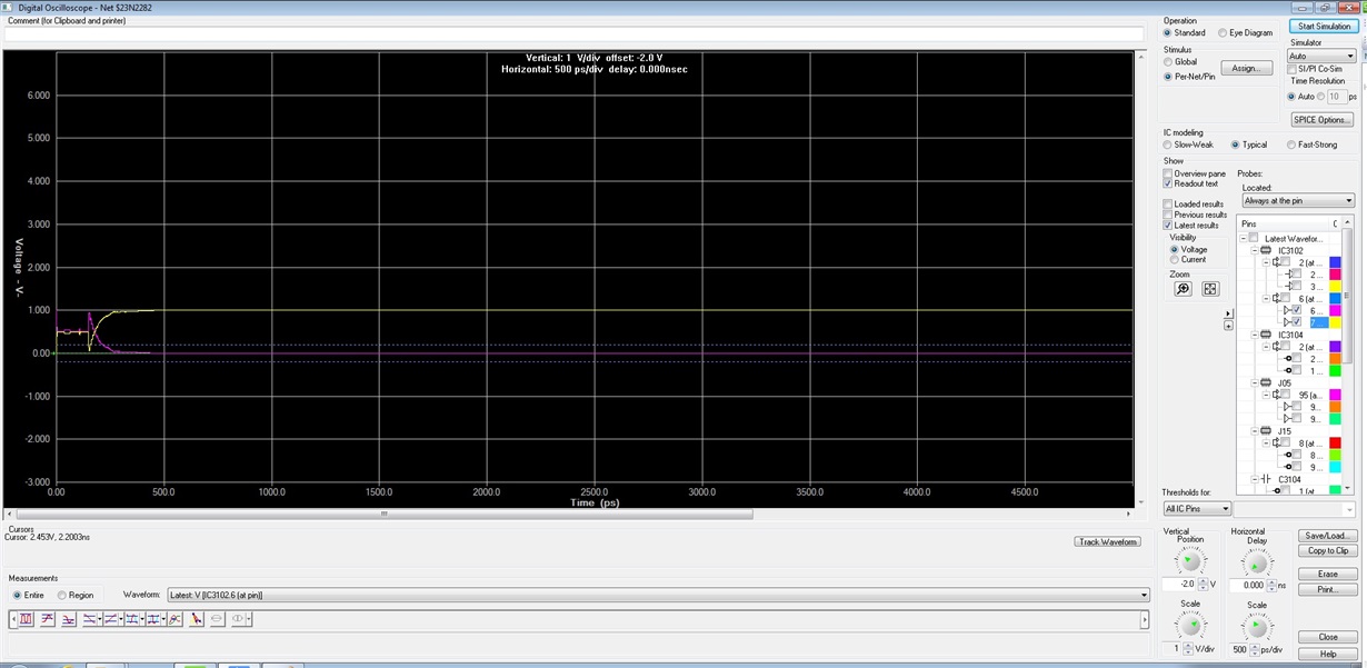

and this is the output signal at the output of the TUSB501 pin 6 and 7. I DON'T KNOW WHY
I have no signal at the output.

  • Hello Nicola,
    I haven't used the IBIS model but I think you must include the 45 - 50 Ohms loads on the TX pairs, so the re-driver enables its output. THis assumption is based on the fact that the TUSB501 requires this load to enable its channel. I will try to run the IBIS model as well in case the loads don't solve your issue.

  • Hello Nicola,
    There is a detection block which is periodically looking for a USB3 receiver, by detecting its input impedance.
    I agree that the datasheet is not clear about this detail, it is only mentioned in the second paragraph of the description, but you can find a detailed description of the procedure in the USB3.0 specification, section 6.11 - Receiver detection.
    My assumption is based on the simulation result, where the TUSB501 seems to be inactive and the mos probably cause would be the absence of this resistive load.
