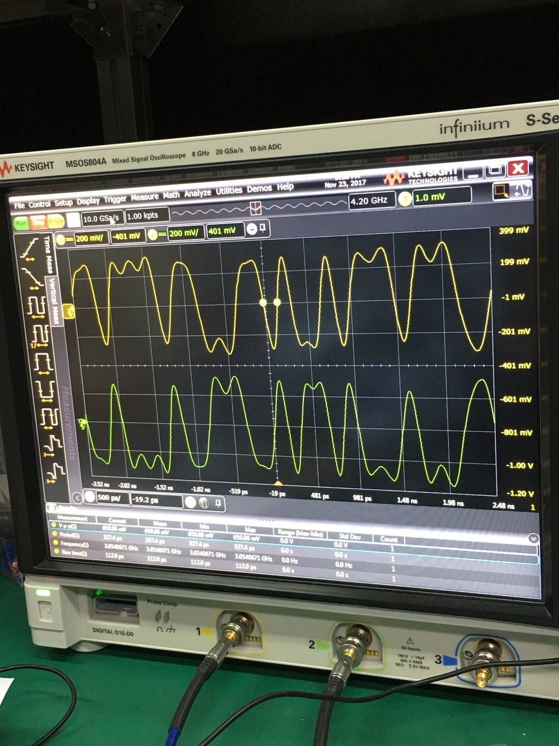

  • Hi Sir
    Need your assistance again.
    I'm using the SigCon.
    I use the sine wave generator with the balun to produce the differential wave in order to lock the CDR and it is successfully to  be locked.
    But when i use the PRBS generator, there is something weird.
    When i enable PRBS generator of the channel which CDR is locked,
    1. choose the CDR tab In the High level Page
    2. In combobox of  the Post Lock Output
    3. Choose the PRBS generator, but the TxN and TxP don't have any data come out.
    4. Choose the retimeddata, there has data come out, the data which is captured by the oscilloscope and the screenshot  attached.
    I suppose that the data should come out when i choose the PRBS generator but it didn't.
    However  the data comes out when i choose the retimeddata.
    I suspect that this data is possibly to be the wave of the  PRBS's pattern superposition on the wave of the  retimer's data ?
    Q.
    1. Is it the correct wave form and the correct operation?
    2. Any suggestion?
    Thank you again.
    John.
  • The PRBS generator should be enabled on the PRBS tab and not on the CDR tab. Go to the PRBS tab, select the desired channel. On the left you will have the option of selecting PRBS pattern and enabling the generator with a single click.
    Cordially,
    Rodrigo Natal
    HSSC Applications Engineer
