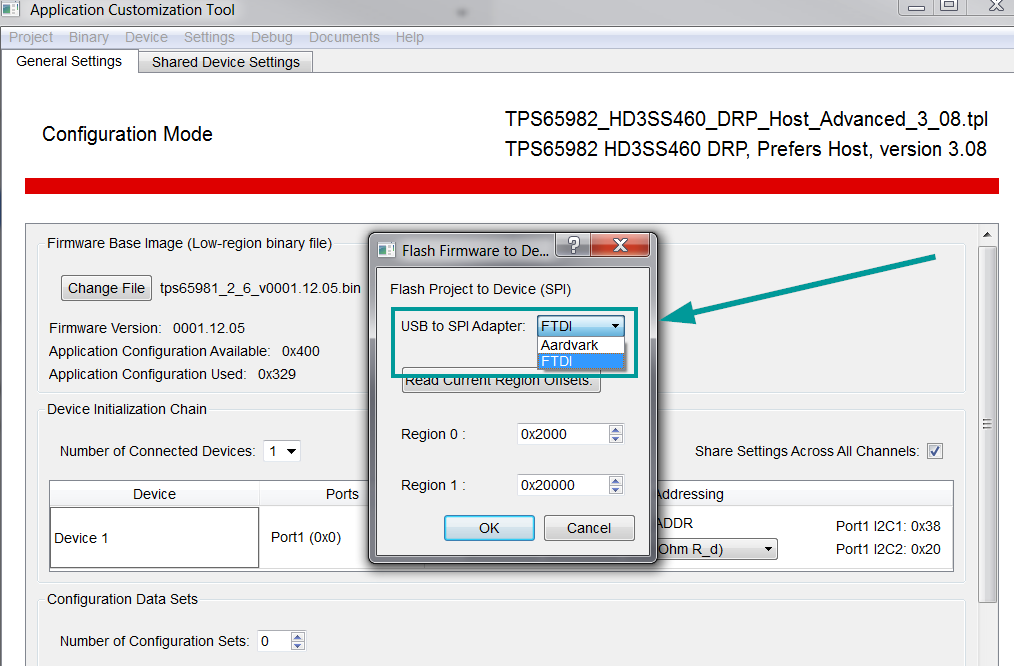

    It has been a while since our last conversation I ordered the TPS65981 EVM board. And finally started to resume the project I was working on. Unfortunately also with the TPS65981 EVM board I cannot program the firmware to any of the TPS65982 boards. The software states: Erasing (even after an hour nothing changed). So I have absolutely no idea why I cannotflash any of the TPS65982 boards anymore (which I was able to do in the past.
  • Hi Mitchel,
    How are you connecting the FTDI board (from TPS65981) to the TPS65982? I was able to flash a template onto the TPS65982 using the TPS65981 FTDI breakout board. Make sure the TPS65982 board sits right on top of the FTDI BOard (Barrell Jack and micro-B facing the same way). Look below for a screenshot:
    Also, when you flash the firmware make sure to choose "FTDI" instead of "Aardvark" in the "USB to SPI Adaptor" Field (screenshot below). I hope this helps :-)
