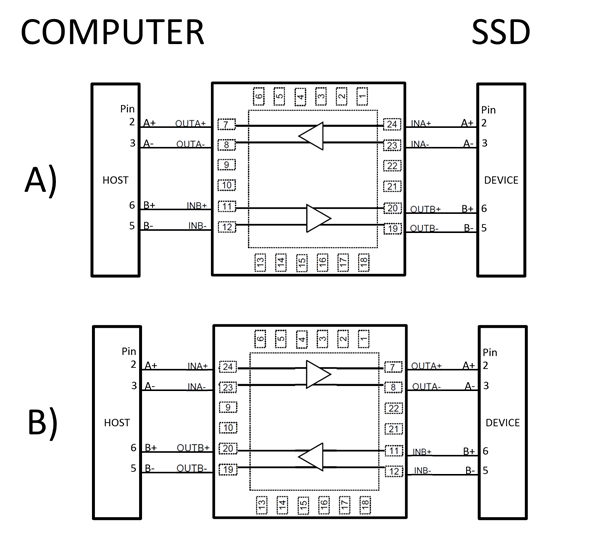

I would like to use a DS100BR111 to interface between a computer and an SSD. Can you please confirm which of the two set-ups below is the correct signal flow? Thank you.

Hi Mark,
From a "Host" perspective the A signals are Transmit Pins, so the receive inputs on our device should be connected to them.
This is shown as configuration "B"
