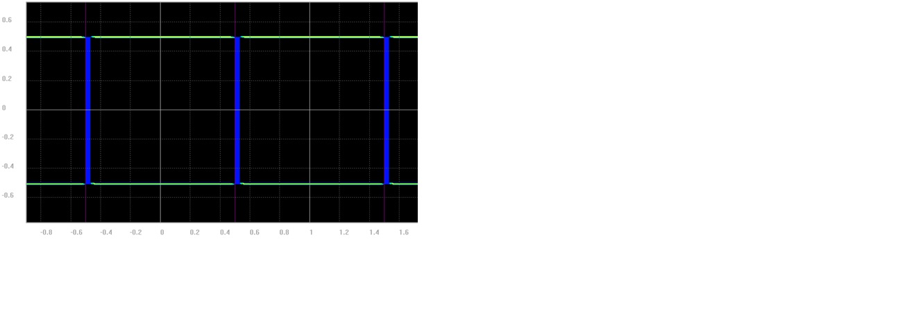

Currently I am doing Signal Integrity Analysis for one of our product by using DS280DF810 Retimer device. So, here I am using Cadence System SI serial link analysis wizard for the serdes simulation. When I am running the channel simulation for Rx nets ( Retimer as receiver), I could able to see the same square wave Rx results without and with considering channel parameters (PCB channels). There is nothing changing in the results. Usually when we are playing with different CTLE and DFE taps settings, we should get different results right? Am I missing something here?, What ever I made some change, I do see the same results. Please get the latest IBIS AMI models, if we need to consider for our simulations. Please find the attached snapshot results for your reference.
Its very critical, because without getting the confirmation on the simulations, we cannot go ahead with our further process. Please help us on this.
Naveenchandra V
  • Hi Naveenchandra,
    Do you have a schematic of the simulation that you can share? We'd like to verify that, if the retimer is not used as a receiver and you just use a generic load termination, you will see that there is a difference in the resulting eye diagram as you add PCB trace to the channel between transmitter and receiver.
    If there is still no difference after removing the retimer, then there may be a setup issue with the simulation prior to the retimer.
    Michael
  • Hello Michael,
    Thank you so much for your reply.
    There is nothing problem with PCB channel, I made it properly. If I use any other devices as receiver, I could able to see the complete eye diagram and difference in the results. But, when I am considering DS280DF810 as a receiver, there is no changes in the results. As I stated above, currently I am usiing cadence System SI wizard for our analysis. Please find the below snapshot for your reference. If I enabled jitter parameters, then I could see slight changes,but not significant changes. What ever results I have capured and shared yesterday, is that correct result? . I have attached schematics for your consideration. Note that, I have not attached tranmitter AMI models, since its confidential. So, you may use any transmitter IBIS-AMI Models for verifications. Please help us on this. I hope my issue would be resolved.

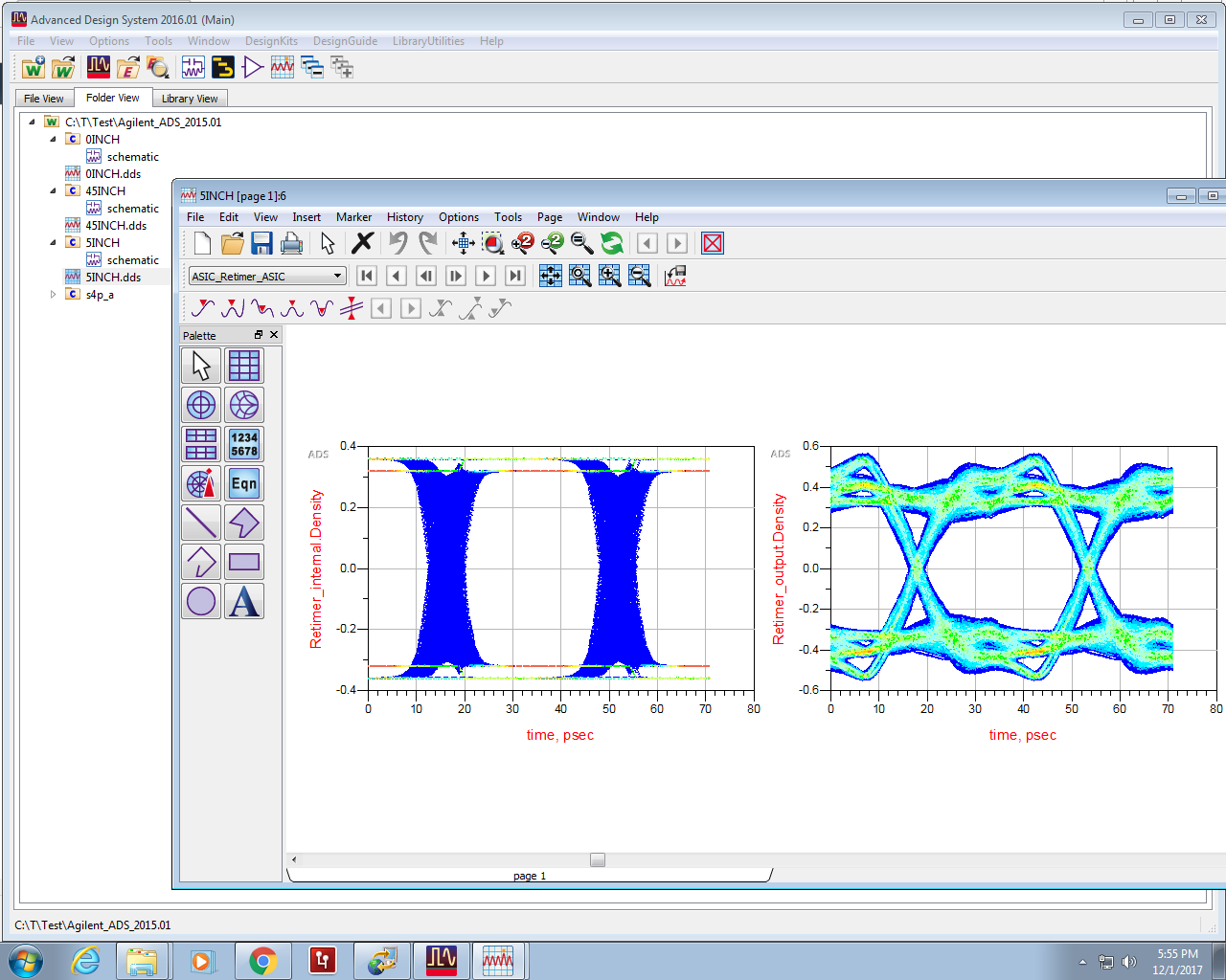

  • Hi Naveen,
    I am not familar with the Cadence System SI tool. Does it support setting up one system simulation with retimer in the middle of the channel, just as we did in the ADS tool?  The repeater pin(connecting the Retimer_Internal probe in the below plot) is expected to observe the pre-sliced signal, which will change as the CTLE/DFE changes.
    Checking the setup as you have, looks like the waveform being checked is already retimed data.
    Liang
  • Hello Liang,
    Thank you so much for your reply. Yes, it support setting up one system simulation with retimer in the middle of the channel. earlier I did setup as same as the ADS tool and I capured the results, Results were similar since we were capturing retimed data. So, for time bieng, I have considered till repeater pin (i.e,after DFE and CTLE) and  I am looking waveform being checked is already retimed data. Every thing correct only. What I want from your side is that, you capure the result and compare my results. If the results are overlaying each other, then we are done. My issue would be resolved. I hope now you understood.
    Naveen

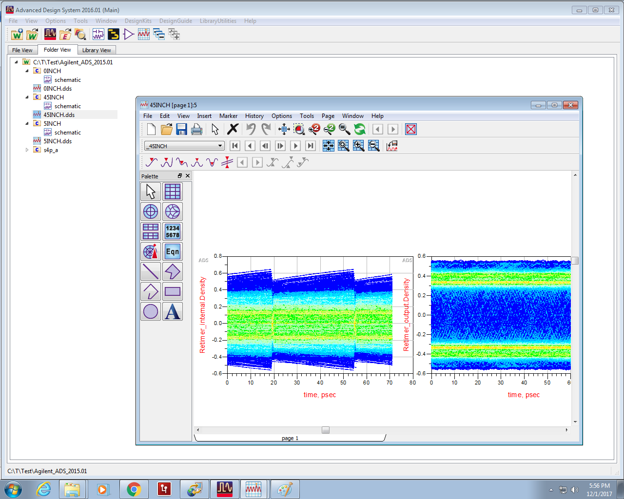

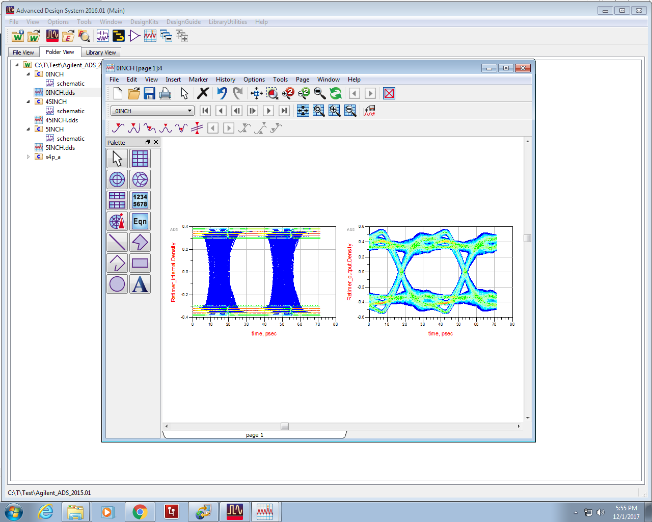

  • Hi Naveen,
    I tried the simulations using 0 inches FR4, 5 inches FR4, and 45 inches FR4 traces as the pre-channels, based on the ADS example we have in the release package. I oberserved the internal eye(pre-sliced) ,and output signal. Please review the plots below
    Regarding the output signal,
    a) There are some pre/pst settings and relection noise from the post channel so that we are seeing some overshoot.
    b) It is almost the same between the 0 inches and 5 inches case, when comparing the retimer_output signals.
    c) I was not abe to get open eye for the 45 inches case.
    Liang
