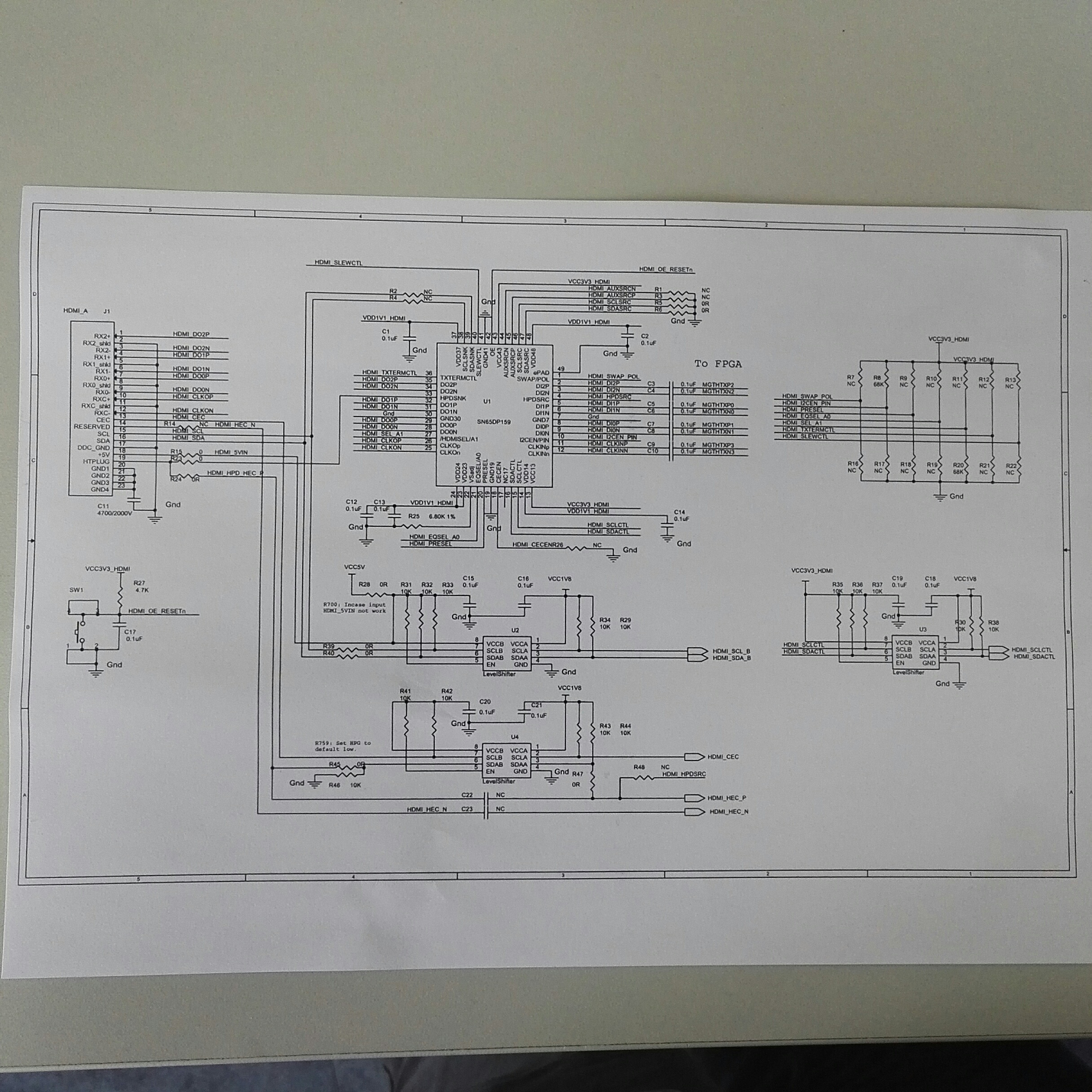

  • Hi Fransisco,
    Thanks for your replay. We are trying a 3840x2160x60p video(4Kx2K60P) on the board, refresh rate: 60f/s, color depth: 8-bit,  YUV4:4:4, bit frate for ch0-ch2: 5.95GHz.
    Actually, we have tried SN65DP159 working in re-driver and re-timer mode with color bars in different formats: 1080P60(ch0-ch2 bit rate: 1.485GHz),  4Kx2K30P(ch0-ch2 bit rate: 2.97GHz), and 4Kx2K60P(ch0-ch2 bit rate: 5.94GHz). Below are the results:
    Video format            SN65DP159  in re-driver mode            SN65DP159  in re-timer mode
    1080P60                    Ok                                                               failed
    4Kx2K30P                  Ok                                                               failed
    4Kx2K60P                  Color error in 2 bars                               failed
    "Ok" means  TV can show the color bars, and the color is right.
    "failed" means TV can show the bars, but color is totally wrong.
    It sounds we have not brought up the device working in re-timer mode.
    SN65DP159 is controlled by I2C in our case. and I will try to send you a picture of the schematic.
    Shenghua
  • Hi Fransisco,
    My work PC has no connection with Internet, I just attached a photo of  the schematic here. I'm sorry it is not so clear.
    Shenghua
  • Hi Shenghua
    Sorry but with the picture is a bit difficult to check the schematic. I attach a check list, please compare with your schematic and if you see something different, fix it and let me know your results.
    With a quick see, I couldn't find any capacitor at OE pin and it is necessary. If you have a pull up resistor on this pin, it doesn't need it because it has an internal pull up resistor.dp159Checklist.xlsx
    Francisco
  • Hi Francisco,
    I checked the schematic with your list, and found 2 pins are NC: EQ_SEL/A0 and  SWAP/POL. For OE, we has a push-button and a 0.1uF cap on it.
    But the color bar is still wrong output from our board when EQ_SEL/A0 and  SWAP/POL are pulled down with 68K Ohm resistors to GND.
    Is there any error in the procedure or register setting of SN65DP159 I listed in my 1st post?
    We didn't use the snoop function of the device on SCDC bus, so we set Reg[0x0B].[1]/[0] to 1s (on page 0)for working with HDMI2.0 4Kx2K60P video. Is it ok?
    In PRBS23 check on the device, what is the value read from Reg[0x0F](Page0) if all thing is ok? We tried such test, and Reg[0x0f] read 0x1e, 0x00, ..., always changing.
    Shenghua

  • Hello Shenghua
    Sorry for my delay, I was out of the office. The problem that I can see is that you handle LVDS mode in the input and these signals are different, can you send these signals through TMDS. This device is able to work with AC-coupled TMDS or display port dual mode. If you can test with this kind of sources I think you should have good results.
    On the other hand, I also took a look at you schematic again and I saw that your I2C pull-ups resistors are wrong. We recommend using 2k pull up resistors. Can you upload the schematic in pdf format? I would like to check it with detail.
    Francisco
  • Hi Francisco,
    Thanks for your effort and help. My problem is mainly in the re-timer working mode of SN65DP159.
    As you noted, I changed the pullups on I2C bus to 2K, but the issue is till there. I also checked the input to SN65DP159, Vswing(Vpp of the differential inputs) is in the range. And the display on TV of a 4kx2k3p color bar is ok in re-driver mode, so maybe the failure in re-timer mode is due to input timing, register setting or something else, but not the input mode.
    In re-timer mode, does the chip re-align the captured signals from the 3 data channels? If yes, when does it  align the data? What special data pattern should be fed to it?
    I also want to adjust the output timing(kind of alignment) on FPGA side for the 3 data channels by S/W, but how could the S/W know a special delay is ok for a channel? Does SN65DP159 have such feedback clue in registers?
    (Although I think it is necessary, but I am sorry I have no means to upload the pdf file of our schematic. Company's policy blocks the outflow.)
    Shenghua

  • Hi Francisco and JMMN,
    I tried the method JMMN mentioned, it really works, and I just set 2 registers(Reg[0x0b]=0x9b, then Reg[0x0a] = 0x3f) after reset, the TV can show the color bar now. Thank you very much.
    BRs,
    Shenghua
