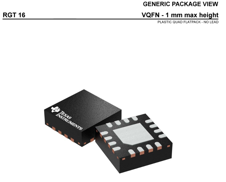

hi Team,
my customer wants to use PCA9534 or PCA9534A, and they prefer small package - 3*3 QFN
the first page of datasheet indicates the RGT package is for QFN. however, in the packaging information session, the RGT still refers to VQFN.
would you please clarify? is QFN available for this device?
THanks,
Mike
  • Hey Mike,
    I believe both the RGT and RGV are for VQFN. However from my understanding, the difference between QFN and VQFN is that the V stand for very thin and for our part, the max height is 1mm. The RGT package should still be 3mm x 3xmm if length and width is all your customer cares about.
    I would trust the packaging information and not the first page of the datasheet:
    I can order samples and send them to my office to verify however I don't think they'll get here before thanksgiving break and I'll be off for the first 3 days of next week.... I can ping you back sometime next week for reassurance if you would like.
    -Bobby
  • Thanks Bobby. I was informed the RGT refer to VQFN with 3*3 size.
