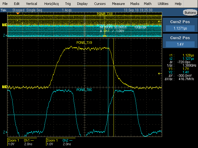

Hi All:
 Because TLK1221 datasheet didn't show out TX data timing, customer followed figure 9 to measure hold time.
Our spec. min. hold time is 0.8ns, but customer got 0.72ns.
Could you tell me whether test condition something wrong or not.
Ex: rise time falling time measure voltage is 1.7V or others.
Please help me to confirm the hold time measured point or offer the TX timing
figure, thanks a lot.

  • Thanks forJon reply.
    Previous waveform was measured TD9 and clk by customer to get hold time 720ps, but that could not meet 0.8ns min.spec.
    Could you give me a TD0-9 wave form as like figure 9. that show out Data and clk measure dvoltage points?
    For example: CLK:1.4V , TD0-9 :1.7V or 2V start to calculate hold time

  • Hi Jon:
    Customer wanted to measure parallel input signal (TD9) hold time.
    Because hold time just show out in RD as like figure 3 in datasheet, I post tiltle is RX measured.
    I am sorry that maybe confuseyou.
  • Hi Thomas,
    The input setup timing setup spec of 1.6nS indicates that TD(0-9) data signals should be stable for at least 1.6nS prior to the REFCLK edge.  This is a minimum number that must be met per the datasheet to ensure the data is sampled properly.  Likewise, the minimum hold timing spec of 0.8nS is the amount of time the TD(0-9) data must remain stable following the REFCLK edge to ensure the data is properly sampled.  It would be preferred that the data is stable for greater than 0.8nS and both the setup and hold time each equal 0.5UI.  Their measured hold number of 0.72nS exceeds our spec of 0.8nS and would indicate that for their test setup we have 0.08nS of margin before we would fail this parameter.
