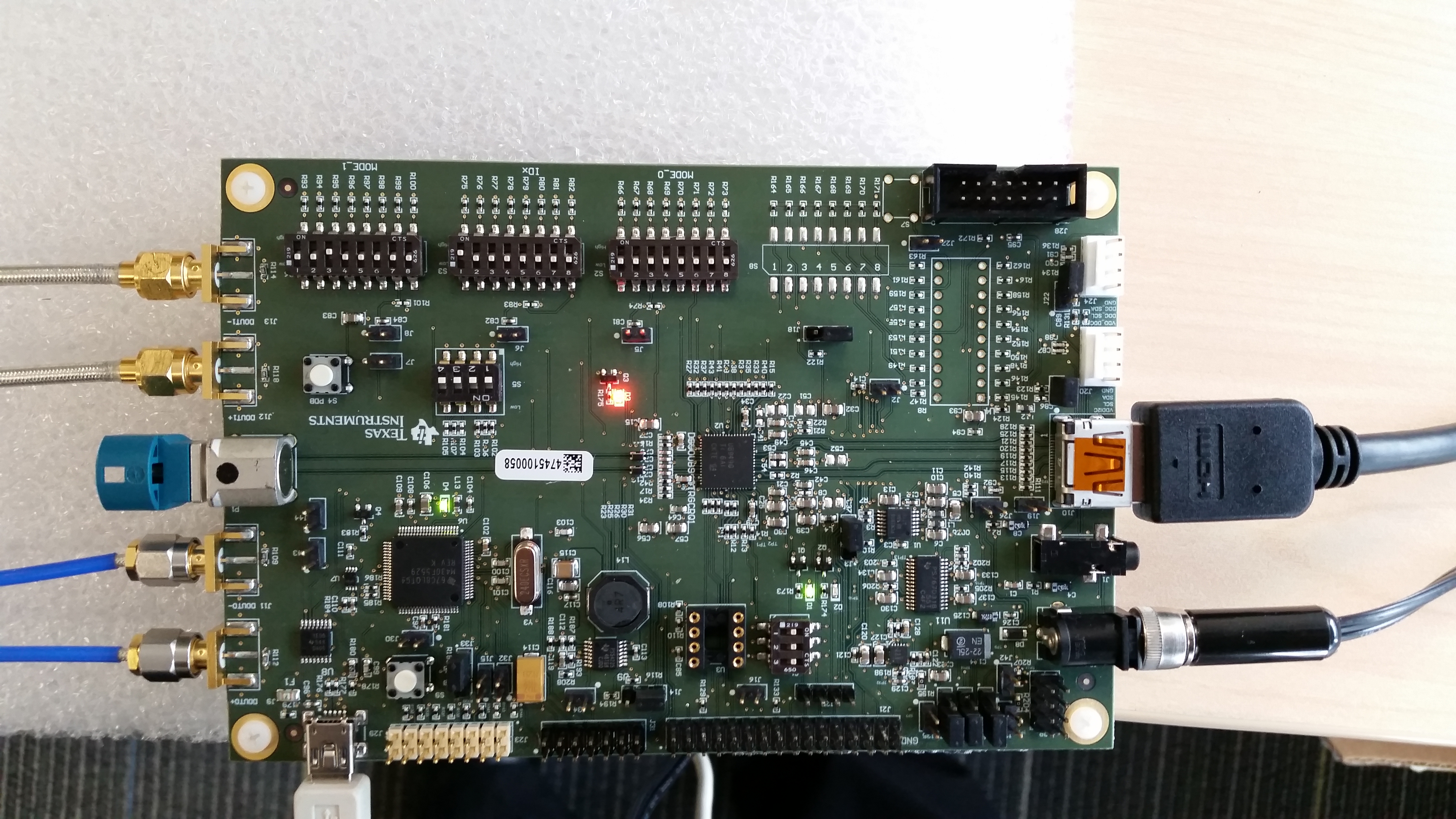

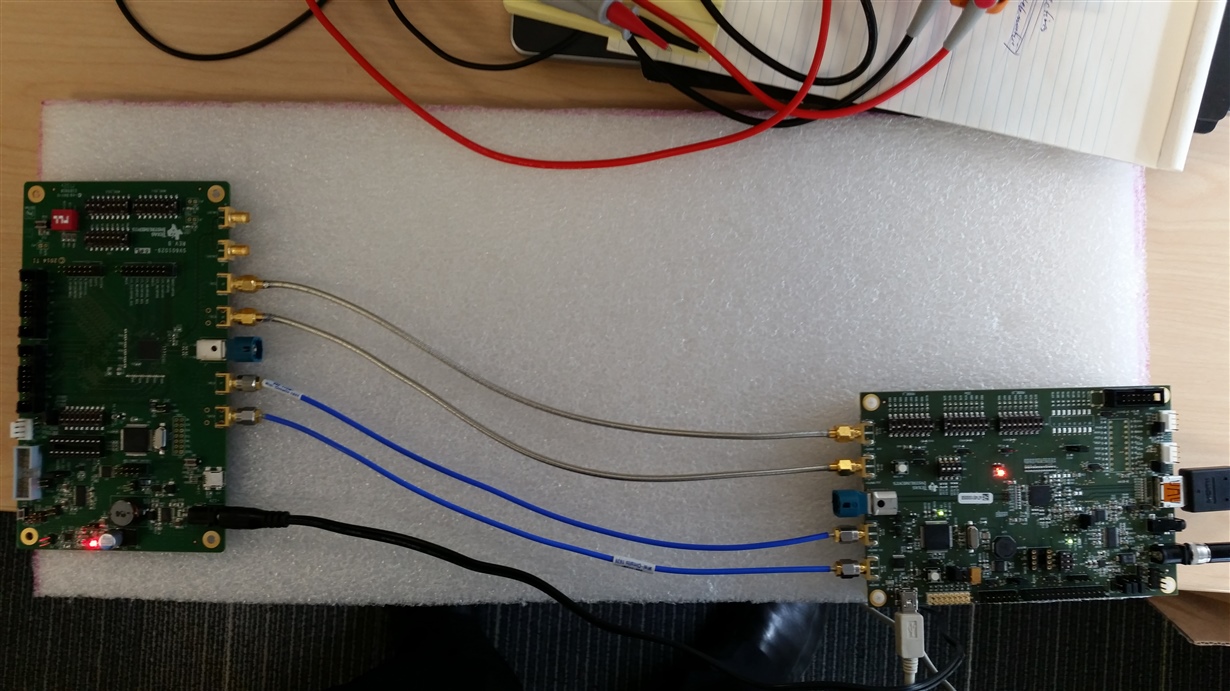

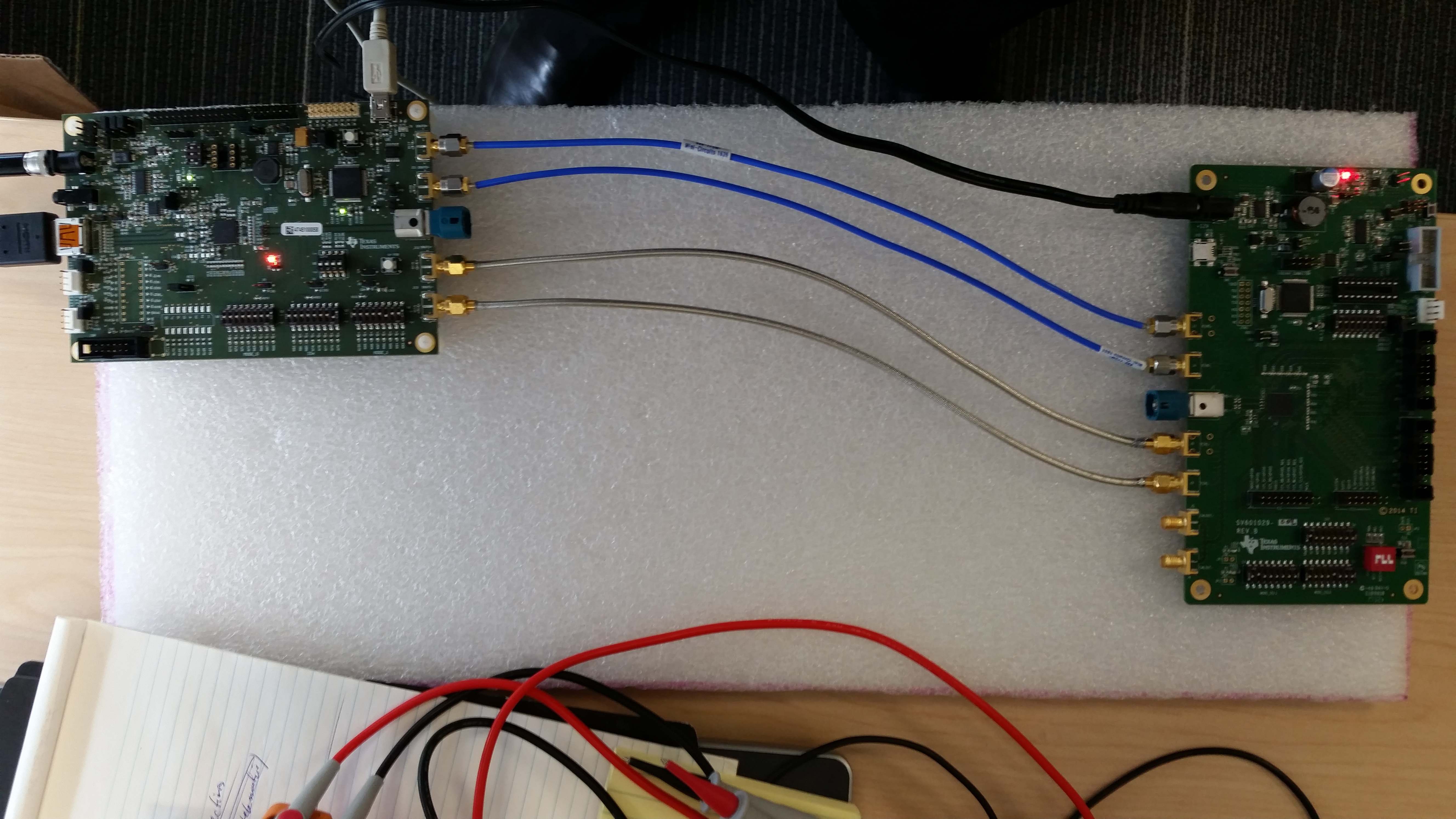

Hello
I tried to connect my DS90UB949 with a DS90UB948 with 4 Coax cables and I am not able to make it works. Also, I'm not able to detect the partner card DS90UB948.
I atteched to this email pictures of my setup and SW configuration and the registers value for the DS90UB949 and DS90UB948.
Thanks for your help.
Thierry

  • Hello Thierry,
    You must populate with 0 ohm resistors on the backside of the 949 board R209, R210, R211, R212; de-populate R109, R112, R114, R118 and ideally remove P1 as there is a stub from P14.
    You must populate with 0 ohm resistors on the backside of the 948 board R37, R38, R63, R63.
    The SMAs are not the default connector but are options.
