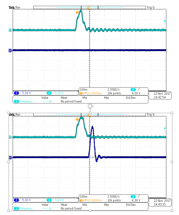

1. What is the minimum pulse width of H level signal and L level signal at IN+/IN-?
2. If the minimum pulse width of H level and L level is 40ns,  what is the output pulse width of OUTH/OUTL when H level or L level input signal with pulse width less than 40ns is input to IN+/IN-? Are OUTH and OUTL level not changed? the previous level is kept? Also is there any problem or malfunction when such short pulse signal is input?
3. When the customer uses UCC5310, do they need to filter the short pulse input signal?

    1. We do not have characterization data on minimum pulse width of H and L level signals for IN/IN-. I can however measure a typical value on the bench if needed.
    2. Any value less than the minimum pulse width will result in unexpected outputs.
    3. Normally we recommend a small input filter for filtering out ringing introduced by nonideal layout or long PCB traces.

    I managed to do a non-verified, quick bench test on a UCC53x0 EVM and a UCC5320 part similar to the UCC5310.
    My results show that with a 40ns input pulse (top scope shot - green) there is no output pulse (top scope shot - blue). Since I only have 10ns resolution on my FG I test with a 50ns pulse next. The results show that the 50ns pulse (bottom scope shot - green) produces about a 30ns output  (bottom scope shot - blue). The minimum width of a narrow pulse on the input is 50ns to produce a similar pulse on the output. For this minimum pulse test there is no need to worry about less than 50ns.
