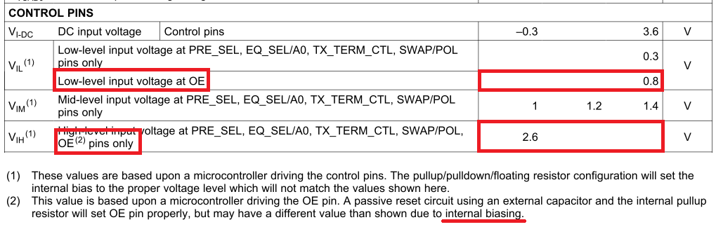

Could you please tell me the internal threshold(VIH and VIL) for the OE pin if connecting a 0.1uF capacitance between OE pin and GND ?
When measured at VCC = 3.3V, the terminal voltage of the OE pin was approximately 2.5V.
In addition, could you please tell me internal biasing as well ?
