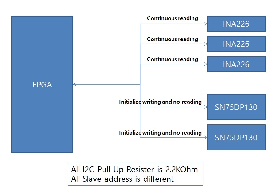

My customer using SN75DP130.
But sometimes 0x01 register value is changed.
This register is about Shutdown Mode in Local I2C Control and Status Registers.
Default value is 0x01.
But sometimes this chip is shutdown, So when they read this register, it is changed to 0x48 or 0x64 or 0x68 or 0x6C.
The bit-0 is 0, so chip is shutdown.
The block is below image.
And when this situation is occurred, There is no writing behavior to SN75DP130.
Please let me know how to fix this.
Thanks.

  • Hello SS
    Can you describe in more detail in what kind of situation they have this behavior? Can you share more information regarding the application, like the schematic? When you said "But sometimes this chip is shutdown", they forced the device to be in shutdown mode?

  • Hi Francisco.
    I attach the schematic below.
    1) No write and read action into SN75DP130DS during operation except first initialization.
    2) After operation 24~48hours, suddenly SN75DP130DS is shutdown.
    3) Read "Local I2C Control and status registers", 01h register is 0x48 or 0x64 or 0x68 or 0x6c.
    4) These register is "forced shutdown mode" because Bit 0 = 0
    Why this abnormal operation is occurred?
    And I tried writing 0x48 or 0x64 or 0x68 or 0x6c into 01h register, but 0x00 is written.
    According this 01h register's vaild bit is BIT 0 and BIT 1.
    But atfer suddenly shutdown, 01h register value is 0x48 or 0x64 or 0x68 or 0x6c and this value's BIT 0 is 0, Forced shutdown mode.
    Any read and write action is not excuted, but register value is changed.
    Please let me know about this symptom.
    Thanks.

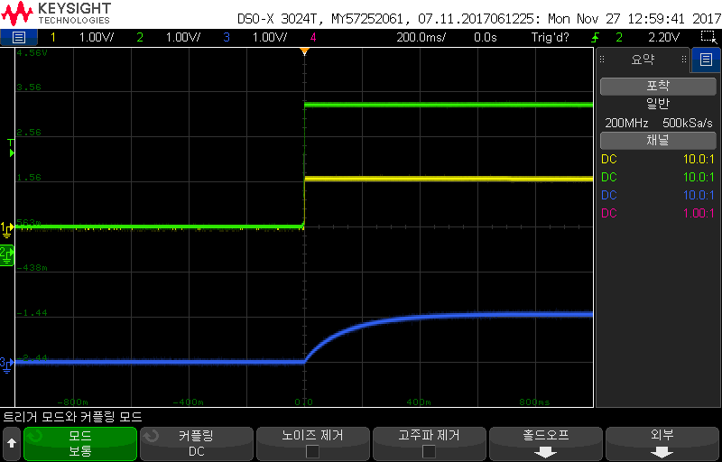

  • Hello SS
    I would like to confirm if you follow the power-up sequence? We recommend to start with .2uF at RST pin and tweak as needed. This one can affect the behavior.
    I would like to confirm the work mode that you are using. If you are using the DP++ the pull-up/down resitors on AUX channel must be on SNK side and the capacitors on SRC side.
    The local I2C lines, have to have 2k pull-up resistors.
    Francisco
  • Hi Francisco
    I already check power up sequence and RSTN's PU resistor.
    I think power up sequence and RSTN's PU resistor is no problem.
    Please refer below waveform.
    Green : VCC (3.3V) - actually 3.3V
    Yellow : VDDD
    Green : PSTN (RESET)
    They using DP Only Configuration with AUX Pass Through mode.
    If DP Only mode, AUX_SNK/SRC PU,PD,CAP is not related?

  • SS
    I also took a look at your timing signals, and they look ok but it's a long time for RSTN. That's why we recommend using a smaller capacitor and you can tweak as needed. If this time is very long, sometimes this device present weird behavior. Then, please change this capacitor.
