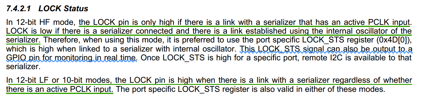

My customer is working on an E-mirror project, with below configuration: camera sensor+933---934+ISP, they would like to have hot-plug function. That's to say, if camera module disconnect with 934, it will connect automatically after re-connect.
The problem is how to detect whether camera module is connected with 934?
Need this information to reconfigure the 933 register after power-on to enable I2C/GPIO passthrough. Customer configures 934 as 12-bit HF mode, from the datasheet, LOCK pin only indicate the PCLK status, not the link status. Can we use the LOCK_STS to indicate the link status? (High= link ok, Low= disconnect)

    You are correct that LOCK_STS 0x4D[0] or LOCK pin should be monitored. As stated in the pasted text, LOCK status indicates a link has been established, which is more than just PCLK detected. Lock status is a current status and so you would need to ensure enough time also for startup transients (~30ms) when lock may be going high and low.
    LOCK_STS_CHG 0x4D[4] is also helpful as this can monitor if lock has toggled since last read.
    For detecting a valid FPD Link III input, it is best to use RX_PORT_STS2 0x4E[2:1].
    If there is cable disconnected these bits would read out 01b = 0x4E[2]=0: Frequency measurement unstable
    0x4E[1]=1: No FPD-Link III clock detected.
    The 933 934 should have LOCK = HIGH before attempting any remote configuration or I2C transactions as stated above.

    I wanna point out that "lock_sts=H doesn't mean Lock=H in 12-bit HF mode", it should be LOCK_STS=H before remote I2C configure is availabe to serializer, just as descripted in d/s. Also confirmed this jugement through 933 and 934 evm.
