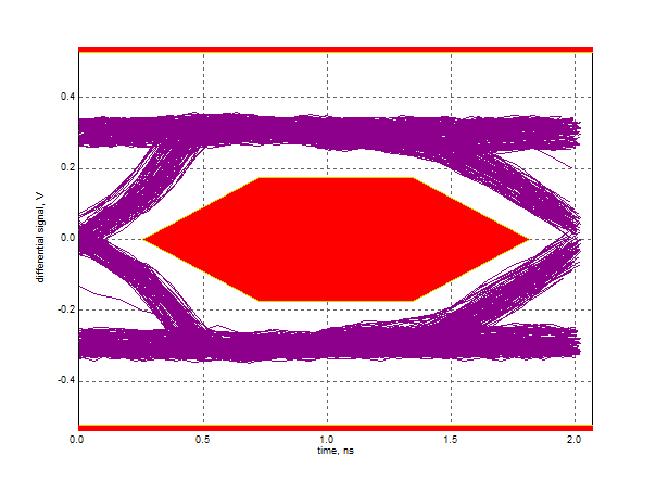

  • Hello Diego,
    Answer to your questions:
    Below is also the eye diagram. In this diagram you can see some jitter (we think it is caused by the cable).
    Some more info during evaluation we did yesterday. Common mode coil between the TUSB211 and USB connector seems to help.
    We think the problem is caused by the current injections towards the laptop. There is also differences if different laptop usb ports are used.
    We made a perfectly shielded EMC-HUB, and if we connect this EMC-HUB between laptop and camera then the emissions are within the limits.
    Best regards
    Peter
  • Thanks for the feedback,
       I would try two things:
    1. change the EQ level to 3.
    2. Try to decrease the drive strength on the USB port.
    Show me your findings using both options.
    Diego.
