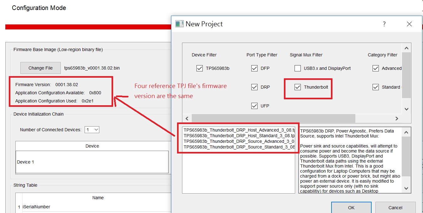

HI Sir
Our NB project use TPS65983B
1. May I know which reference code could be used for host side in TPS65983B 3.08 GUI
2. Does TI have TPS65983B EVM ? we can purchase one pcs
3. If I want to use a typeC device to test host side TPS65983B ,may I know this device need to support PD2.0 or this device I can use TPS65983A to test with TPS65983B

  • HI Atiq
    I had already got the TPS65983B GUI
    We follow Intel reference design schematic to do and install below four reference code in my NB project
    But no one can workable and TPS65983B can't supply 5Vout
    And We find the four reference code have the same firmware version ,may i know this is correct ?
    Please check which reference code could be used with Intel coffee lake reference design or something I need to check first ?
