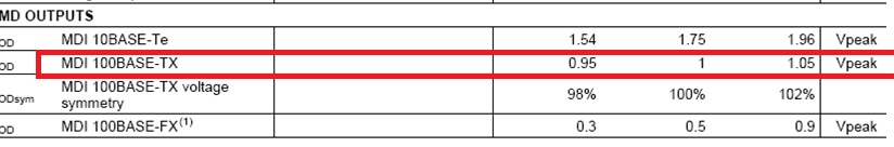

I have several questions about PHY, can you do me a favor to check, thanks:
1. Take DP83822 as example, we have the PMD output specific for 100BASE-TX as below, so do we also have the specific for receiver input? Is it same with Output specific?

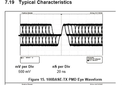

2. For the eye waveform we showed in our datasheet. Not sure what's the test condition for this eye waveform, for example we test this waveform when connected to transform and RJ45 connector? If not, pls correct me, thanks.

    The PMD output spec is defined in the IEEE standards and the device is tested to make sure that it is compliant to IEEE standard. The standard however does not define the receiver input requirement for the PHY, so it is not possible to test that.
    For generating the eye diagram, the PHY is configured to transmit MLT-3 scrambled idles by writing 0x2100 to register 0x00. The output of the PHY is connected to 100ohm differential termination resistors via RJ-45 connector and Cat5 cable. The differential probe is then used to measure the signal across the 100ohm differential termination resistor.
