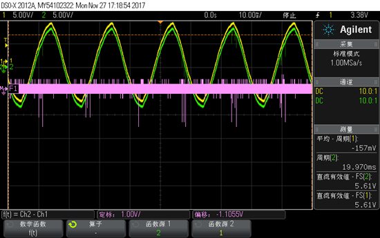

When DP838221 is tested, the waveform of pin TD_P and pin TD_M are shown in the picture below, can it meet the needs for actual use?

    Are the yellow and green traces from the PMD signals? Is the customer using a Differential probe?
