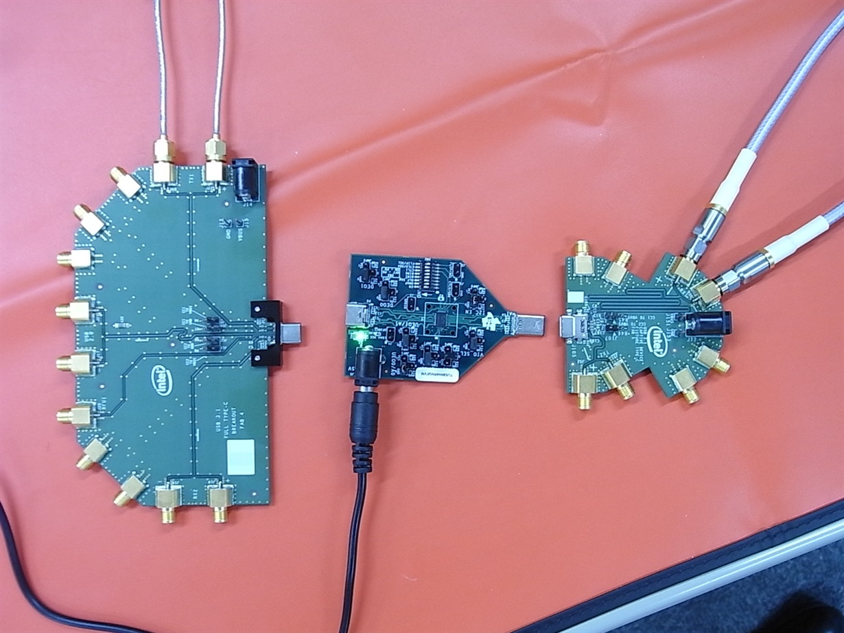

 My customer is evaluating the TUSB544 by EVM, he checked USB 3.1 only mode at first.
 But output signal did not appear. But when HPDIN connected 544_VCC, USB 3.1 signal was appeared.
 I could not find that HPDIN pin need to connect VCC from EVM Usre's Guide.
When evaluating USB3.1 only, is it necessary to fix HPDIN pn?
 EVM setting is below.
Intel test fixture board (SMA to Type-C) -> TUSB544-EVM -> Intel test fixture board (Type-C to SMA)
EN            :   H
SWAP      :   L
SLP_SO  :   H
DIR1        :   L
DIR0        :   L
CTL1       :   L
CTL0       :   H
FLIP        :   L
