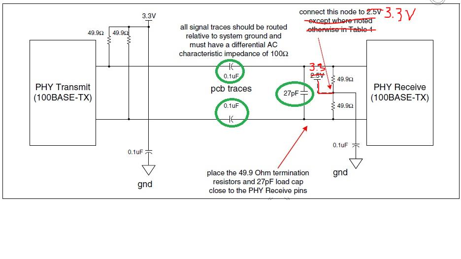

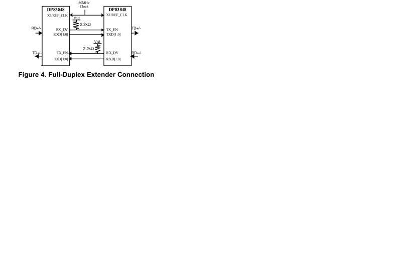

Could DP83867 support below two topology as Serdes mode for system board internal communication upon transformerless ? Thank you.
BR
Patrick
