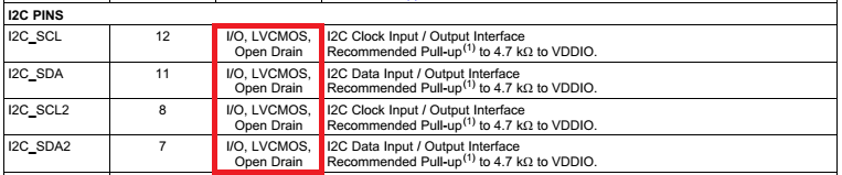

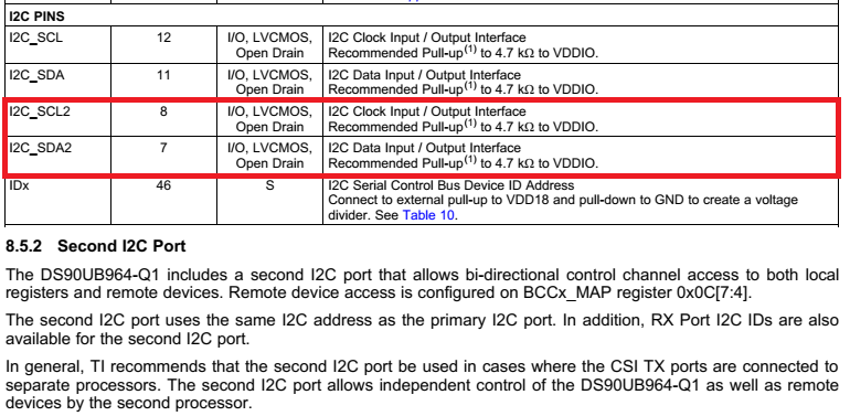

[ DS90UB964-Q1 ] Unused Second I2C Port
If we don't use second I2C port (I2C_SCL2, I2C_SDA2), how should these pins be?
Does that still require pull-up resistors? or can be left open?
