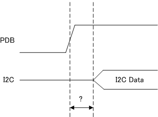

I would like you to confirm delay time which DS90UB914A-Q1 can accept I2C access after PDB is released.
Could you please confirm this ?
It is recommended to wait 2ms after PDB goes high to access I2C, ensuring all internal circuitry are stabilized.
