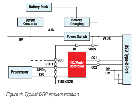

  • Thanks Luis. Ok, I now understand the dead battery mode operation, but in most cases, the battery won't be completely dead, it will just be discharged. If we then connect VDD directly to the battery as shown in this diagram (from the "Low-cost USB-C Implementation" whitepaper) then TUSB320 does have valid VDD. In this case is it possible to detect and enable fast (3A) charging? Assume the rest of the system is still powered off (so I2C is still not possible).
    I understand that it is not a full-fledged schematic, but the battery charger block in this diagram is not shown to have any interface to the CC pins (or to the TUSB, or to the processor). In a USB-C system, how is the charger expected to figure out charging current capacity?
  • Hello Vikram,
    In GPIO mode, the TUSB320 only advertises default Type-C current level. If your application needs a higher current level I2C is mandatory. As well, the Try. SNK and Try.SRC are specific features for I2C mode.
    Luis

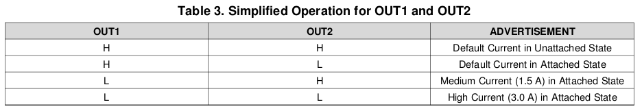

    Would you clarify this some more? Per Table 3 in the datasheet:
    Isn't the "Attached" state determined only by VBUS detection? So if connected to a charger-only source, will the TUSB not be in the Attached state? (And if it is, it ought to indicate the current level in GPIO mode?)
