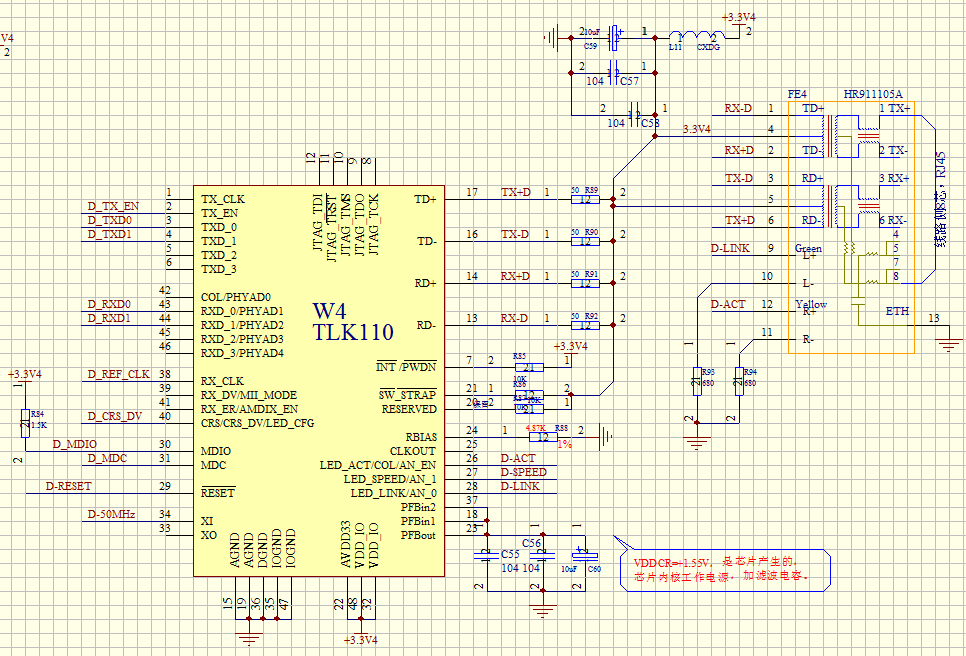

Hi all:
    The attached file is the schematic diagram, can anybody help me to check the file.
    Tlk110 is working in rmii mode. My question is pin 6(TXD_3) must have an external 2.2kohm pulldown resistor, according to sllu155.pdf (http://www.ti.com/lit/ug/sllu155/sllu155.pdf).
    After some days debuging, I can read and write all the registers in tlk110, but I can not connect to ethernet. The register 0x02 is always 0x7849. The following talbe is the values dump from the tlk110.

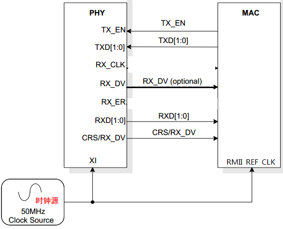

  • Hi Rodrigues
    Another question, Is the RMII_REF_CLK coming from the tlk110 and send to MCU? Thanks.
  • Dear Rob:
            Using an RJ45 loopback cable, I can get a valid link and ETH_RMII_REF_CLK is 50MHz. But using a real cable whether if this cable is MDIX or MDI, tlk110 can not make a valid link and ETH_RMII_REF_CLK is about 4.3MHz. I also try to write register 0x09 to value 0x7C61 and set register 0x19 bit 15, but it is useless. The phy sch is below:
    So what is the wrong? Thanks.
          I also have a design under tlk110 datasheet page23 figure 4-2, the phy sch is below:
        In this mode, using an RJ45 loopback cable, I can not get a valid link.
    Thanks.

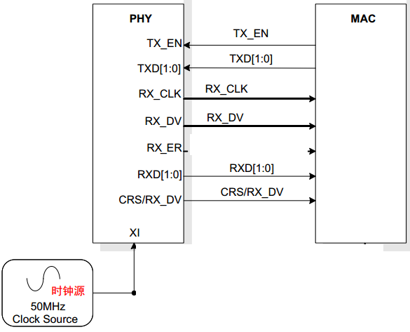

  • Dear Rose:
    According to tlk110 datasheet page8 pin 39(RX_DV),
    I add a pull-up resistor, the whole tlk110 sch like bleow
    In this mode. RJ45 loopback cable, real RJ45 cable both can establish a valid link. But a very strange thing happens, tlk110 pin 38(RX_CLK) is 25MHz. In RMII mode, the pin 38(RX_CLK) shold be 50MHz?
    So what is the problem? and using RMII mode, tlk110 pin 39 must have a pull-up resistor?
    Thanks.
    It sounds like there is an issue with the processor.
    The PHY does not control the external clock source.
    RX_CLK will output a 25MHz clock in 100Mbps operation and a 2.5MHz clock in 10Mbps operation.

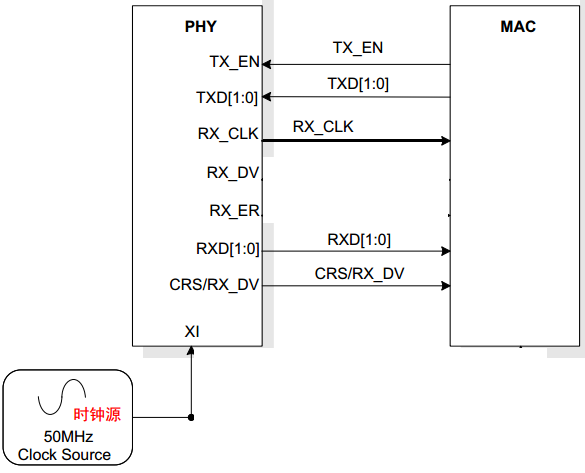

  • For RMII operation, the PHY must be bootstrapped into RMII using the MII_MODE strap.
    Yes, please have an external pull-up.

  • Yes, but if the PHY initializes to MII, even if you change that bit for RMII the PHY will not go into RMII operation.
    You must boot the PHY into RMII operation using the MII_MODE strap.
  • Dear all:
    I have fixed this problem. It is a hardware fault, the pin39 must have a pullup resistor to indicate RMII mode. Using RMII mode can not config by register.
