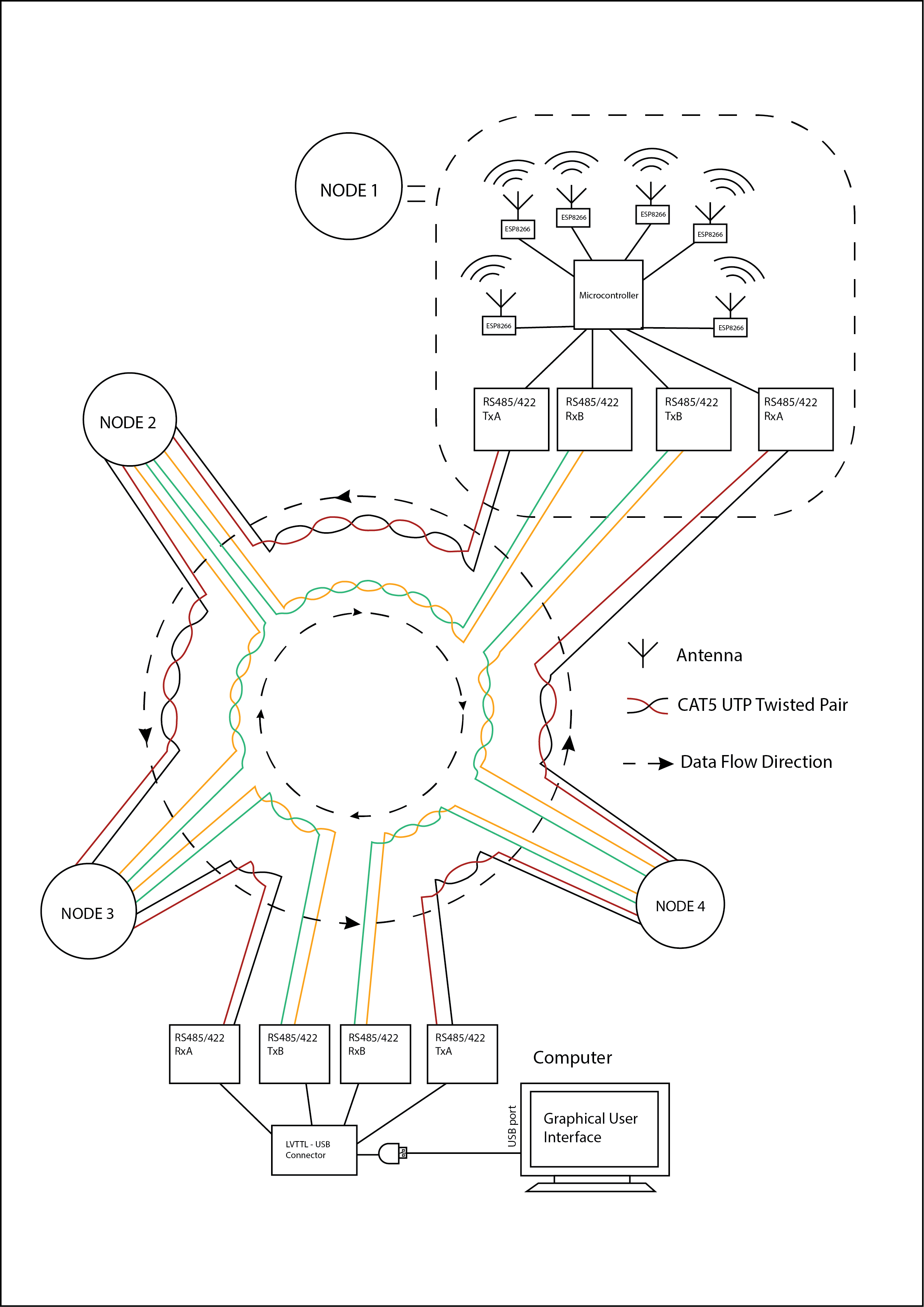

I am designing an RS422 point-to-point link ring network (connecting STM32 uControllers) with DS89C21 Transceivers. The distance between the 2 nodes will be 2 km and I will be using UTP twisted pair. May I know if tidu0033 repeaters will work with the transceiver ?
I am fairly new to comms, can anyone guide me on the bandwidth I should be looking at ? the data which I am going to transfer won't have anything to do with imaging so I suppose the data rate shouldn't be high. How can I determine that?

    From what I understand is that RS422 doesn't have DE RE pins, therefore reducing the complexity of implementation. My application was to implement a CDDI, so I imagine I can get  4 RS485 transceivers to imitate RS422, whereby 2 of them with always enabled Driver and two of them with always enabled Receiver. Or maybe just 2 full duplex transceivers, one for each ring.
    The problem is my application was just point-to-point links between nodes and I was asked the question, why not consider RS422? May I know if there is a particular benefit of using RS485 over RS422 in point-to-point link ? If not, could you recommend any good repeaters in RS422?
    Yi Zen
    P.S. The system diagram is as follows:
  • Hi Yi Zen,
    For a point-to-point application, there probably isn't an advantage to using the RS-485 physical layer versus the RS-422 physical layer; either one should work. I just wanted to point out that RS-485 transceivers were an option as well. Since RS-485 is mostly a superset of RS-422 (it is similar but extended to cover multipoint applications with larger node counts), most newer devices are developed with RS-485 in mind but will support RS-422 as well due to similarities between the standards. In this case you should be able to pick a device based on whatever other characteristics you like (e.g., presence/absence of enable controls, internal ESD protection, etc.).
