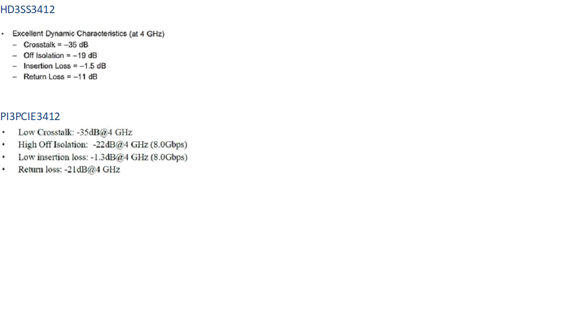

My customer feedback HD3SS3412 eye diagram is worse than PI3PCIE3412. both is pin to pin solution.
I think the relevant specifications are as follows is right or not? Please help me how to explain with the customer. Thanks~

Hi AJ,
The biggest difference in the specifications is the return loss. It looks like this application layout highlights this difference.
Do you have the eye diagrams of the input and output waveform comparisons which you can send me via email. lee.sledjeski@ti.com
