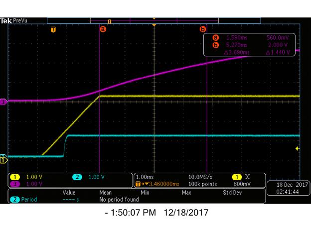

I have a couple questions about the TUSB4020BI GRSTz input specs. The timing spec is that VDD (+1.1V) and VDD33 (+3.3V) must be stable 3ms before GRSTz is de-asserted.
Question #1: Must this timing spec be met even if the GRSTz pin is subsequently asserted and de-asserted after power up? What happens if the spec is not met at power up? We have processor control of this reset pin, and we could give it a reset pulse if we need to. Or might the hub get into a dangerous state (latch-up, etc.) if the power up reset timing is not met?
This spec says GRSTz must be low for 3ms after the 2 supply voltages are stable. A strict interpretation of this would be:
  • For the supply voltages, “stable” means each supply reaches its final level, not just some level close to that level.Or is it 90% of final value?
  • GRSTz must be at or below its VIL spec + its min hysteresis spec during the 3ms window. VIL is 0.8V, but there is no min spec on the input hysteresis, so I have to assume it is 0. Therefore, GRSTz must not be above 0.8V for 3ms after both voltages are stable.
Question #2: Is this correct? Or is the spec really that GRSTz must not go above VIH until at least 3ms after both voltages are stable?
For reference, below is a scope capture (voltages stable to GRSTz=0.8V and GRSTz=2.0V). The hub function is fine in this case, but for the strict interpretation of the spec (0.8V), the reset is low for only 0.44ms after supply voltages stable.
Ch 1: VDD33
Ch 2: VDD
Ch 3: GRSTz
Rohit Joshi

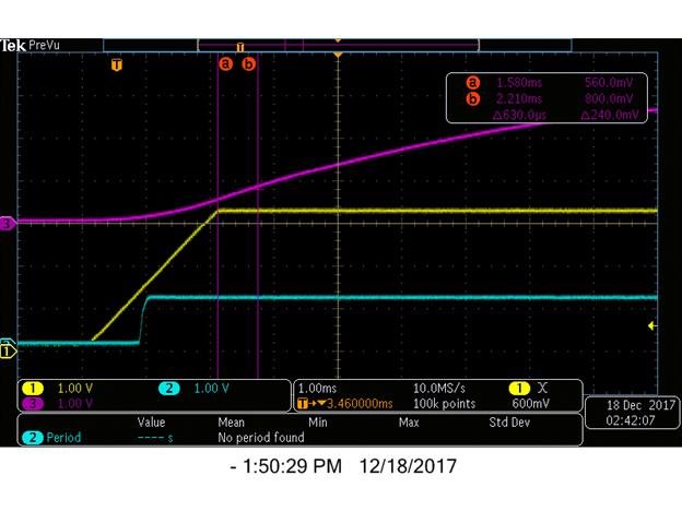

  • Hi Jorge,
    Can you describe what happens to the hub if the power up sequence is not met? Does it go into a state that can be recovered with a simple reset pulse or does it enter a dangerous state (latchup, etc)?
    I have added an RC delay on GRSTz. It takes 630us to reach 0.8V and 3.69ms to reach 2V. According to Vih limits in the datasheet, this should be fine. Can you confirm if the following would be acceptable to the hub?
    Rohit
  • Hello Rohit,
    Device may operate incorrectly when power-up sequence isn't meet; although it will represent no risk for the device. Proper device functionality should be recovered at any time by asserting the reset terminal for over 3 ms.
    Your power-up sequence looks good to me, so the device should work fine and reliably.
